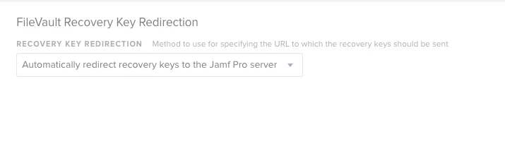

We currently have a configuration profile that enables the FV2 & Redirects the Key back to JAMF servers.

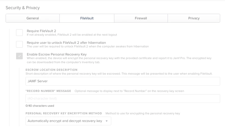

@JarvisUno I believe Apple needs to fix it because I created a custom FV config profile (signed) only with the required keys and could reproduce easily. The easiest fix seems to use a policy 'At next login' combined with a config profile to require FV and to escrow the recovery key.
@jordy.witteman This would be that custom script you posted on your thread correct?
@JarvisUno Yes if you only want to use a config profile without any policies that one should work if you paste that in the PayloadContent of the mobileconfig file. For now I use the following successfully without having to use the custom config profile:

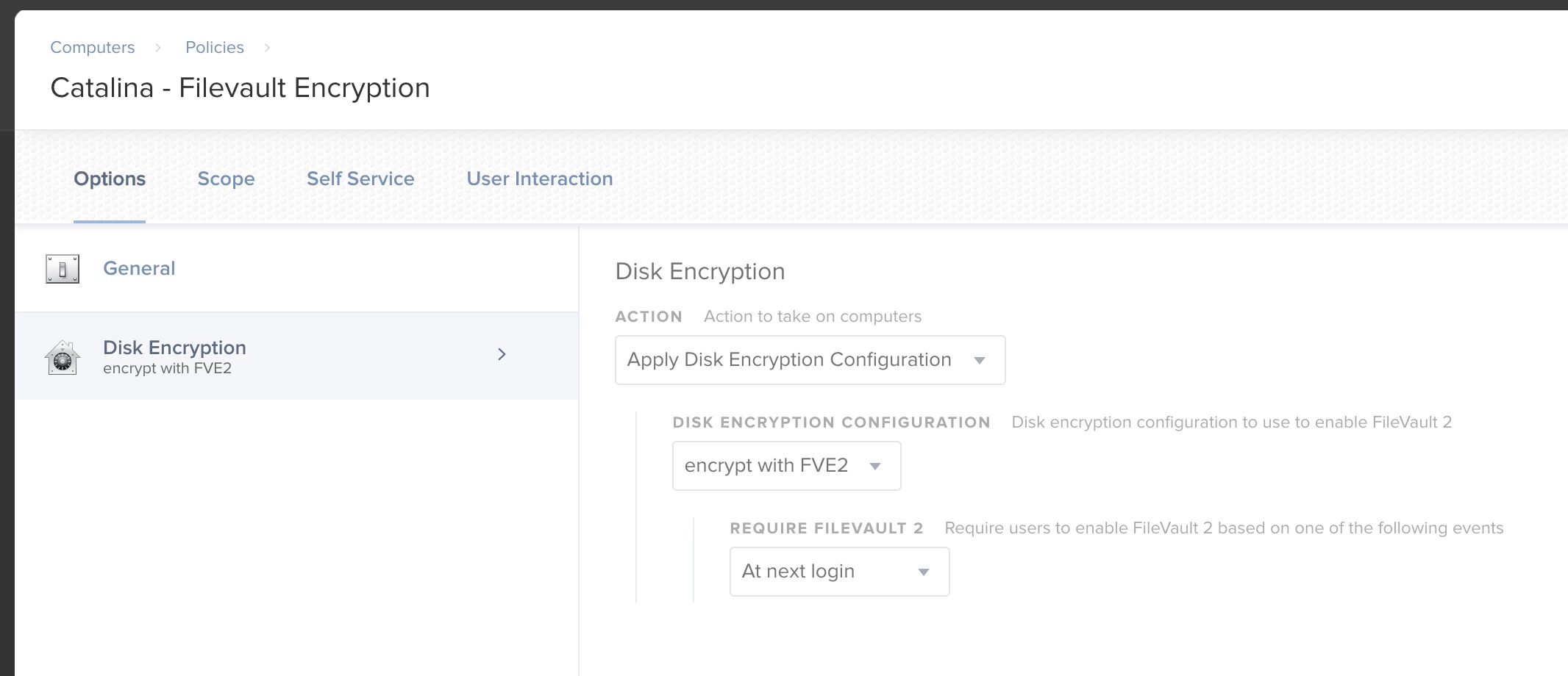

Config Profile --> Security & Privacy: Require FileVault 2 + Escrow Recovery Key
Policy with Disk Encryption: At Next Login

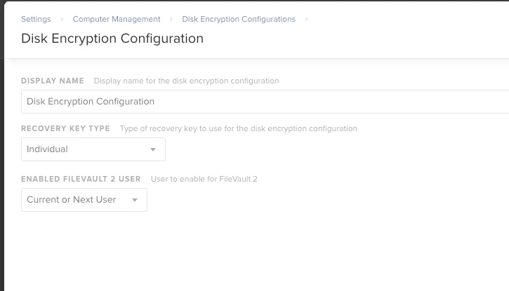

i have that setup too except no "require filevault 2"
its set to current or next user
however, it just loops and loops and by random chance it would do the encryption.

there are other threads about this: https://www.jamf.com/jamf-nation/discussions/33538/title#responseChild195408 but basically the Filevault doesn't enable at logout, but it works at login. My quick solution was to set up this policy and scoped to Catalina computers. there is an extra reboot involved in our provisioning process but it works.

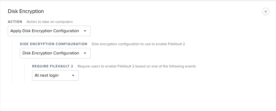

@strayer That is current policy I have setup it was working just fine it's now looping and I restart it multiple times but it never turns on FV2.
It's very frustrating because I thought I was passed this issue already and well here I am again.
same as you @JarvisUno
literally same setup with next login, only thing i notice that we have different vs everyone else so far is that they . have "require fv2" checked in your second to last picture.
