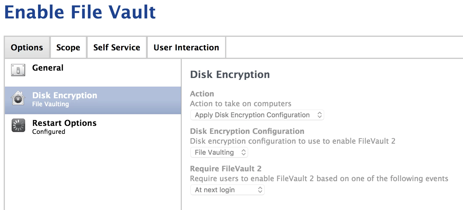

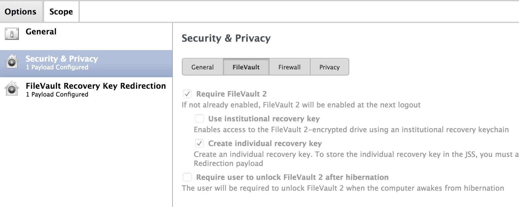

We have configured File Vault 2 as a policy and scoped it to users, and we have noticed that Turn off file vault option is available for them. We have created a configuration profile and which does the job and disable the option of disabling File Vault.
Question is, which one to use? if we decided to go with Configuration Profile what time the policy is going to trigger? and should we get rid of the file vault policy? Please suggest.
@ism Use a Configuration Profile to enforce the setting if you want to ensure your users can't turn off FV2. Configuration Profiles are executed as soon as the client machines get a notifications via APNS, so if they're awake and on the network it's almost immediate. If you use a Configuration Profile to set FV2 you do not need a separate Policy for it.

  1. I still think even with the "blocking" configuration profile, the user can still disable it from the CLI.
  2. Last I checked there is no way to set the enable profile to enable on log in, in my testing any other enable trigger the user can "cancel" and then still user the computer. If the policy is configured enable profile to enable on log in and the user "cancels " it the machines just reboot to the log in window again and the same FV2 enable window.
