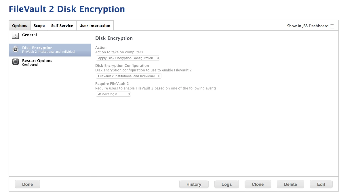

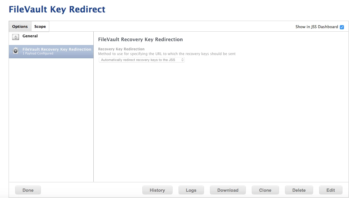

@roiegat What you are missing is that what they are using is a config profile pushed down by Casper to the client that has a filevault redirection policy that redirects the key directly to the JSS instead of a local file.
Basically you have two options of getting the recovery key from a machine. When you use the regular built in Casper FV2 policies on the system, it will write the key out to an xml file that is hidden in /Library/Application Support/JAMF/. The file has a . before it so you can't see it by default. On the next recon the JAMF binary sees the file is there and uploads it into the database.
When you use a configuration profile with a FV2 key redirect, it tells the computer whenever it runs a command to generate a new recovery key or to encrypt the machine, to redirect that recovery key to a URL on the JSS and the JSS inserts the recovery key into the computer record.

That file only exists if you use the built in Casper filevault policy with no configuration profile. The file will get written but as soon as a recon detects the file and submits the key to the JSS it will delete the file. So the only time you are going to see it is immediately after you initiate an encryption via a Casper policy.

@roiegat the hidden xml file gets removed from the Mac once a recon is performed (for obvious security reasons), so in your case it may have already been scooped up and deleted.
Try it again on another Mac not encrypted and look in that directory right after it reboots and you log in. It should be there, unless as @chriscollins mentioned, you are using the recovery key redirect configuration.
You can also keep the Mac completely disconnected from the network after reboot to prevent it from being picked up.
