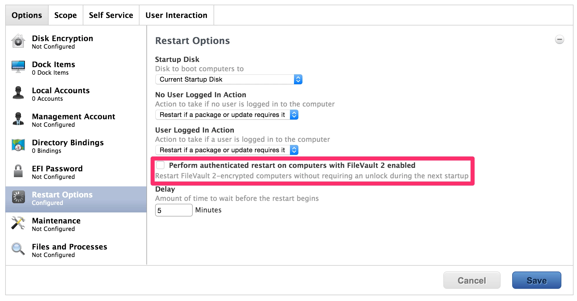

  • March 26, 2015
@kitzy
Do you know if the option for authenticated restart is in v. 9.60? I can't find it. That'll be a reason to upgrade because FV2 isn't going anywhere and I need that functionality.
mm2270
  • March 26, 2015
authenticated restart (or authrestart) is an fdesetup function. Is it also something that can be called from the JSS? I don't think it is, but if so, I wasn't aware of that.
kitzy
  • March 26, 2015
I'm not sure exactly what version the option appeared, but I can confirm that it's available in v9.65.
mm2270
  • March 26, 2015
Wasn't even aware of that option. I must have missed that memo :)
Its there on our 9.63 JSS, so it goes back at least to that version, but perhaps earlier. That's a good one to know about.
I also see that Casper Remote 9.63 has the same checkbox in it. The 9.61 version I had lying around does not have that option, so my assumption is version 9.61 of the JSS didn't have the ability to do this.
