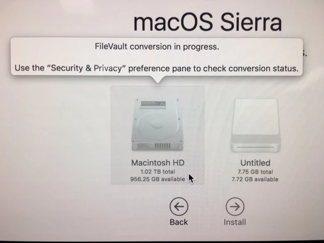

I have made some progress though. Retrieving the FileVaultMaster.keychain that was set up on the server and copying to a USB, I've managed to follow this "If a user can't log in to their iMac" guide to get the drive unlocked.
The current roadblock is what to do then. I can't re-image it as it says "FileVault Conversion in Progress", and I can't run any commands (like sudo fdesetup disable) in terminal as everything I've tried retrieves a "command not found". Restarting re-locks the drive, so I'm now trying to work out how to get around a non-completed FV encryption but with an unlocked drive.

Issue has pretty much been resolved now. Copy the FileVaultMaster.keychain from the server to a USB, then use the above linked guide to unlock the drive, then Disk Utility to format it and re-install the OS.

Yeah it wouldn't allow a format as 'un-mounting' the drive required authentication.
And it wouldn't install over the top either. I believe it was just bad circumstance where it was still 'mid encryption' pending that final restart. I would have assumed the JSS would sync the Recovery Key as soon as it's kicked off, but I guess if they restart prior to the 15 minute check-in - it gets missed.
