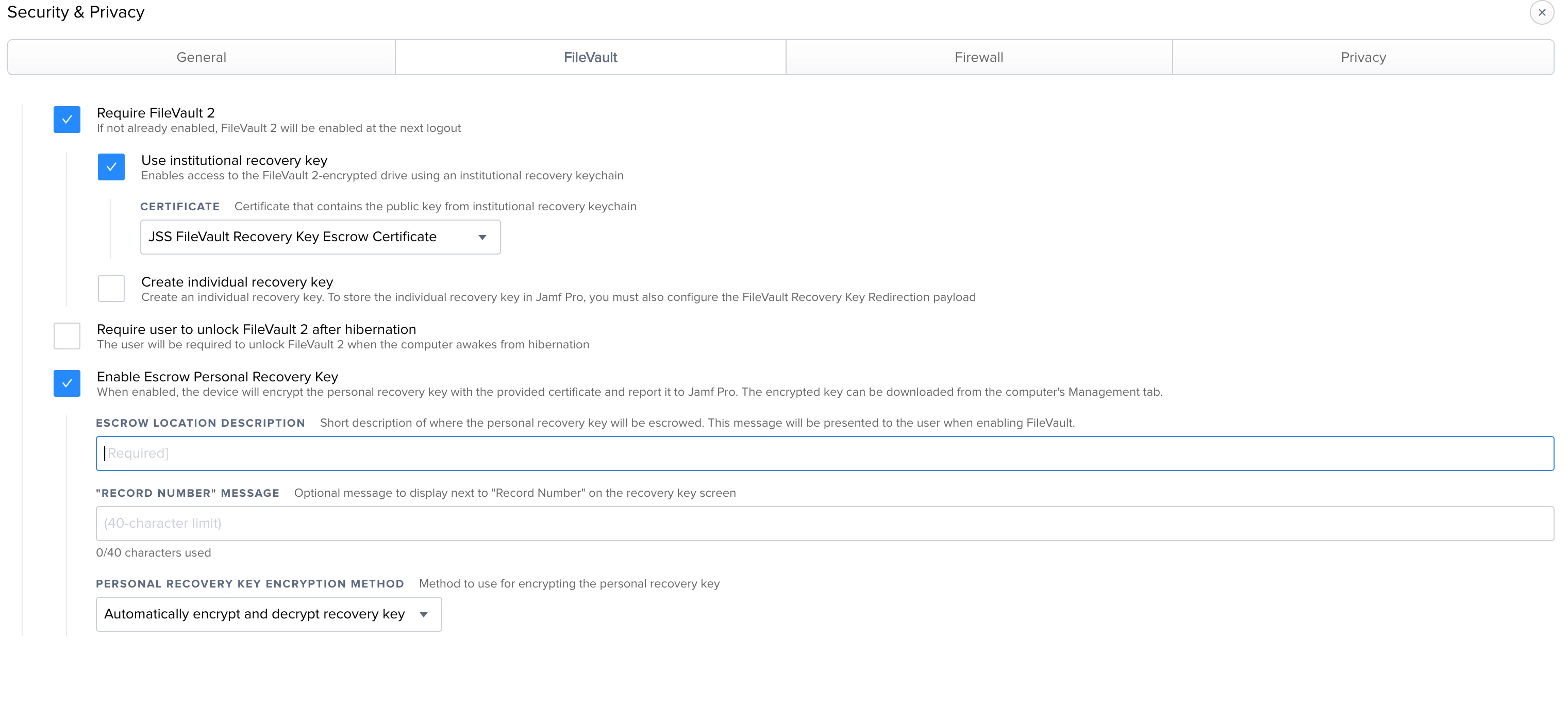

I have been tasked with enabling Firevault on our Macs, for some reason we didn't enable this to begin with but now I need to do it, at least for new Macs going forward.
I created a config profile and tested on Mac, it worked fine when I logged out the user account however it's not writing the key to JSS. I thought I may have screwed up, I didn't use an institutional key.
So what is the proper way to setup FileVault to have it write the key to JSS?
We are running the latest JSS and this will refer to 10.13 machines only

With 10.13. it can be a little confusing as the "FileVault Recovery Key Redirection" payload in the configuration profile DOES NOT WORK!
Instead you have to use the Security & Privacy payload. At "File Vault" you can find an option called "Enable Escrow Personal Recovery Key". This is what you need. Enter the URL of the JSS and it should work.
Hope this helps with the reporting issue!

Where do I put the jss url? Those fields are just descriptions aren't they?
Also do you know what happens with machines where FileVault is already enabled? Can the JSS grab the key or is there a way to pull the info?

You enter the JSS URL in the "Escrow Location Description" field. And yes, it should also work to get the key if FileVault is already enabled.
  • July 25, 2018
Actually I see the key stored in the management tab now. That was strange. I guess I did have it setup right, but I still don't see a place to add the JSS URL
  • July 25, 2018
@mkolb Thanks! I should be good now.

OF COURSE it will get stored inside the JSS the configuration profile got pushed from..
What you enter in this field is just the text, that get's shown to the user when FileVault gets enabled. Something like "Your trusty IT Department" and then the user would get a message like "Your FileVault recovery key will be stored at Your trusty IT Department".
So yes.. should work to report no matter what you enter there... sorry for the misunderstanding!
