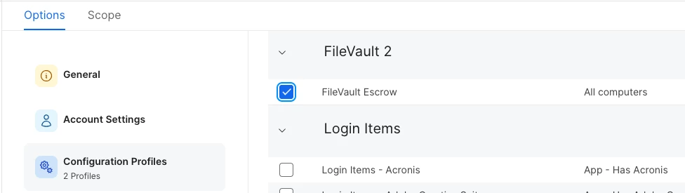

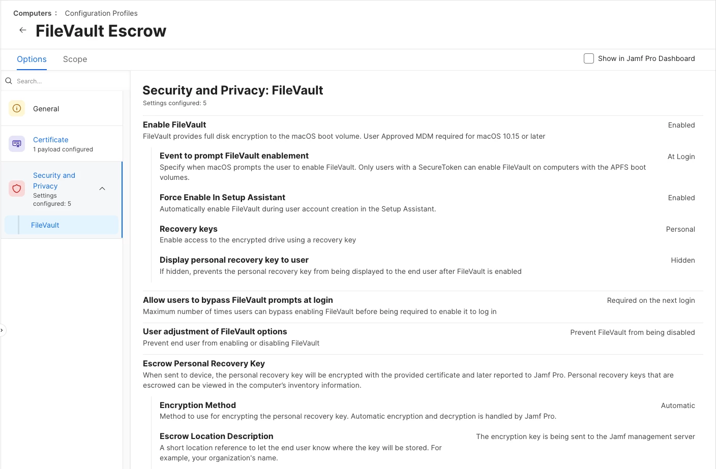

What I do is the following:
  1. Set up a disk encryption in a Config Profiles under ‘Security’ (the certificate will add itself)
  2. In my PreStage, I’ll then add the Filevault profile to the Config Profiles module
  3. I set up Escrow Buddy to capture any machines that have an invalid key or are not escrowed

My configuration profile for Filevault is similar to ​@Tangentism.
You could run this against your Macs that don’t have Filevault setup via a smart group.
Have it Enabled at “Force Enable In Setup Assistant” is nice too for new onboarded Macs.

Enabling FileVault across all your Mac clients is crucial for data security, and you're right that there are two primary ways to do it: via a Policy or a Configuration Profile.
​@JakobHansen dont enable FileVault with a Policy. Using a Policy uses CLI to enable FileVault and apple has deprecated that workflow, it still works but it is not supported and can stop working at any point and does not prevent a user from disabling FileVault. Use a Configuration Profile.

Configuration Profile is the easiest method to do encryption at scale and especially with escrow.  I almost don’t even think about it anymore since it integrates easily.  I would make sure to test your workstation onboarding process for when to best add the configuration profile.
