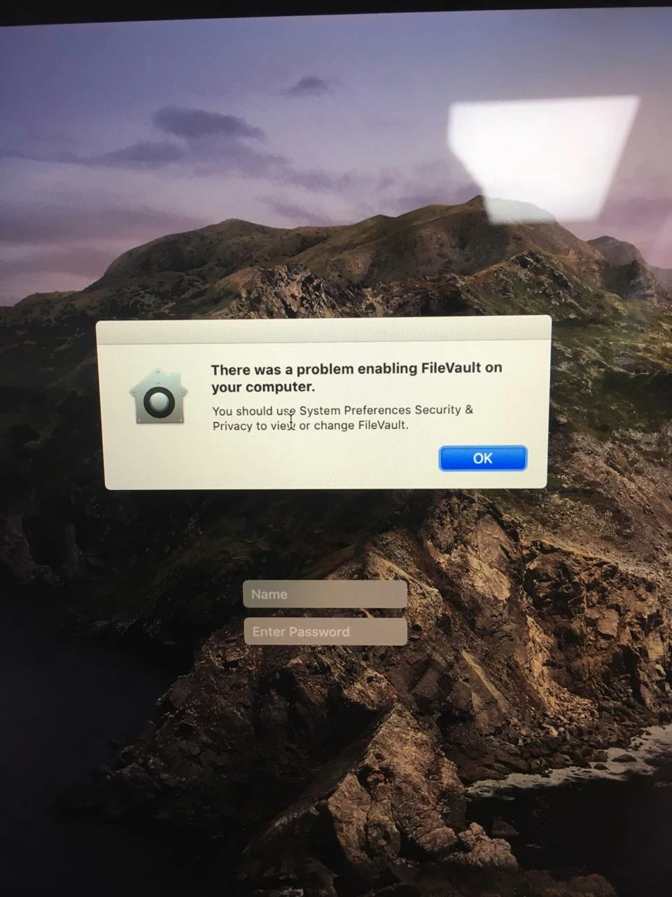

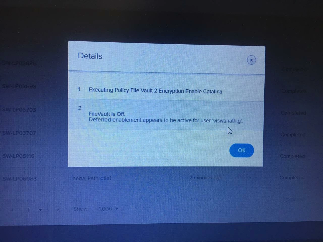

maheshveldandi
While turning on File-Vault getting error “there was a problem enabling FileVault’.One more error Defferred enablement appears to be activate for user '1-user'.. Suggest the ways to resolve the issue.
