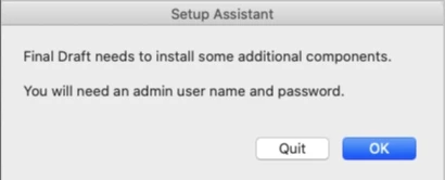

Thanks, just tried this for FD12, the above commands are all in a Post Install script in the .pkg, seemed to work OK in testing but the first user is getting an admin prompt.
Any ideas?
Any ideas?

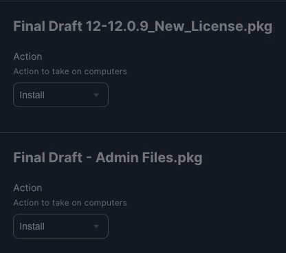

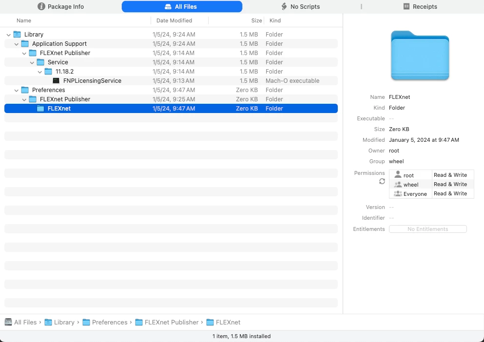

To stop the Admin Prompt that appears upon first launch.
Create a PKG with the following.  Set them to Root, Wheel and 777.
Then with your Installer Policy, add this secondary PKG.

I do recommend the Jamf 200 and 300, it goes over the concepts of creating post install scripts which opens the door to so much automation.
To create this package, open Composer and include both FNPLicensingService and the subfolder FLEXnet in a single PKG. This process will incorporate the parent directories but exclude other files and folders. Next, select the FLEXnet Publisher folder within the package and change it to Root with 777 permissions for both instances stored in Application Support and Preferences.
This PKG does not have a post-install script. When deployed, it will copy these folders and files into the existing Application Support and Preferences folders (not the User's Library folder).
In your Jamf policy, add both the main Final Draft installer package and this Folder PKG. The prompt appears because the necessary licensing folders have not been created yet. A non-admin user lacks write permissions, using Jamf's Admin account, the Folder PKG addresses this issue by creating these folders with write access. Once Final Draft runs for the first time and sees that the required folders exist and are writable without admin privileges, it prevents the prompt from appearing.
