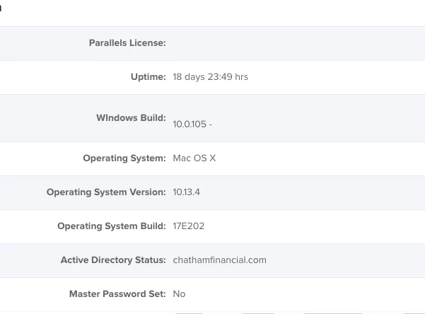

@Cornoir So i tried that script and it seems to cut off the rest of the info. Any thoughts?
  • July 13, 2018
In the script this line is truncating the info:
vmosversion=$(cat "/$i/VmInfo.pvi" | grep -i realosversion | awk '{print substr($1,16,8)}') 2> /dev/null
I suggest running the script from the terminal with the sh -x prefix to see what is getting cut off and then edit the following section to display what you need (and then post the fix here for all):
