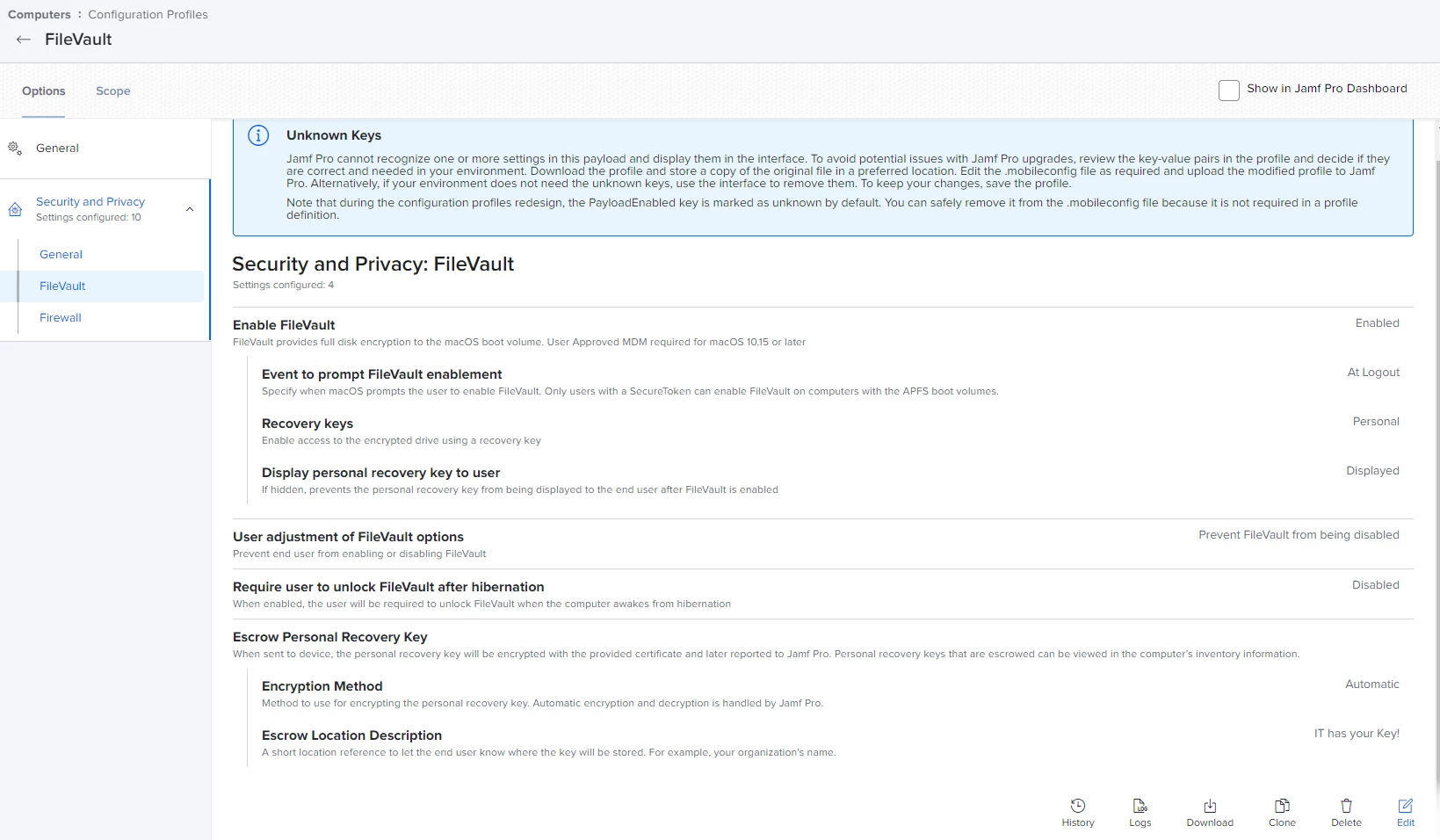

Configuration profiles has worked better for me then policies. You have the choice of personal, institutional, or both recovery keys which to me made the most sense to do personal (seems self defeating to has single institutional key that would work on all) , but you will want to escrow those into Jamf and there is no manually uploading for that. Below is a sample config;
