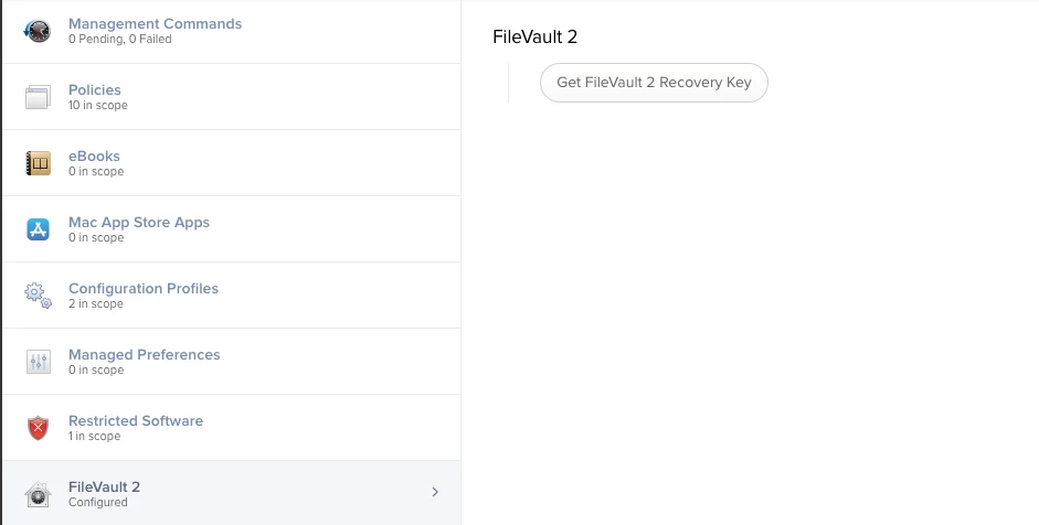

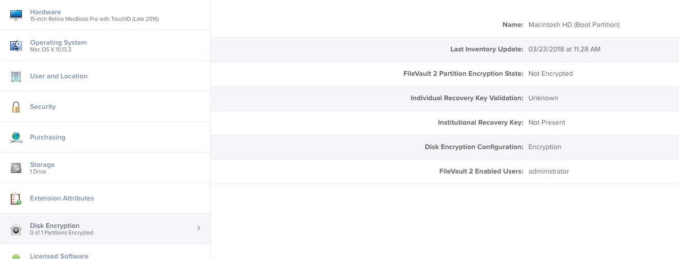

Hi, we just implement JAMF Pro last week and I am trying to figure out some things when it comes to FileVault 2 encryption. In the first and 2nd screenshots I have attached you can see it says "No Partitions Encrypted" for the FileVault 2 state. However if I go to the management tab it says FileVault 2 is configured and I can get the recovery key. On the MacBook I can clearly see that FileVault is on. Any ideas on why that is happening?

For the first part, is the inventory updated since encryption has been done?

Yeah, just did an inventory update a couple minutes ago and get the same thing with "No partitions encrypted" even though we know it is encrypted.

It will say "no partitions encrypted" if encryption is in progress or paused.
For High Sierra APFS systems, you also need to enable AD users and make sure they can be granted a secure token from your local admin account. They won't automatically be FV-enabled.
Once I updated the inventory it now shows as encrypted. So that problem is solved!
