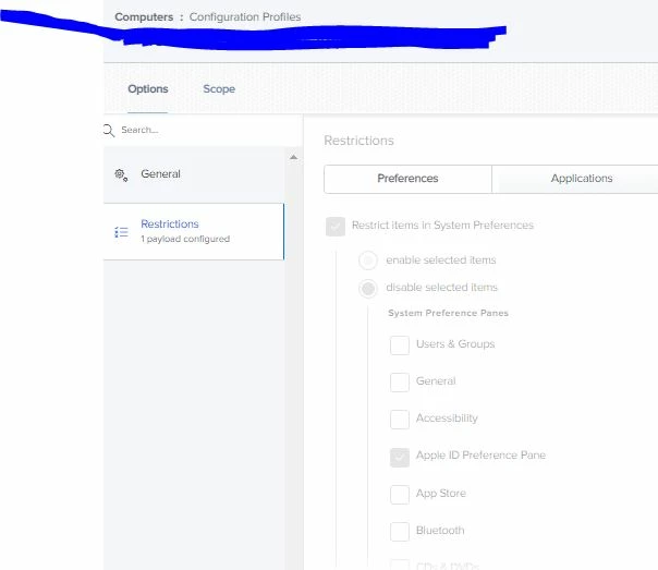

I've the same question.
We tried disabling "Apple ID Preference Pane" from jamf using configuration profile.
But still looking for more option.
Thank you.

How do you did that ? Does it work ?
We tried this and it works,
I too have this restriction enabled however users still login in some half formed way. Even though the panel is restricted, there are some apps that prompt for AppleID login I'm guessing the messaging app or something else and it half signs them in. I don't know exactly how they do this, I have asked and gotten a "what's that" and legitimately believe them because that's a normal answer. However I am not trying to go around asking and then it's known they can achieve this in some unapproved way.

Hi,
i was struggling the last few days with the same. On our side we had an additional CP for restricting changing computername (this because the jamf pro built in feature for this stopped working with ventura)
The first one for: com.apple.loginwindow
The second one for: com.apple.systempreferences
this problem with the computer name was also discussed here in the forum
<?xml version="1.0" encoding="UTF-8" standalone="yes"?> <!DOCTYPE plist PUBLIC "-//Apple//DTD PLIST 1.0//EN" "http://www.apple.com/DTDs/PropertyList-1.0.dtd"> <plist version="1.0"> <dict> <key>UseComputerNameForComputerRecordName</key> <false/> </dict> </plist> <?xml version="1.0" encoding="UTF-8" standalone="yes"?> <!DOCTYPE plist PUBLIC "-//Apple//DTD PLIST 1.0//EN" "http://www.apple.com/DTDs/PropertyList-1.0.dtd"> <plist version="1.0"> <dict> <key>DisabledSystemSettings</key> <array> <string>com.apple.Sharing-Settings.extension</string> </array> </dict> </plist>
However, this helped for the issue with the computer name, but also enabled or better explained: disabled the restriction for the apple id pane we had configured sooner.
it took some weeks after i start to find some user which has registered an apple id. So i started to search for an solution. I discovered today, that the additional workaround CP for the computer name restriction is no more needed.
So today i was able to find the solution for us:
  1. unscope the CP for the computername restriction
  2. waiting until removed from the macbooks
  3. unscoping the cp restriction for the appleid pane
  4. waiting until removed
  5. scope back the apple id pane restriction cp
 Maybe this help you a little bit. Also when you do not have an additional CP for the computer name, try once to unscope the CP for the AppleID restriction and scope back.
