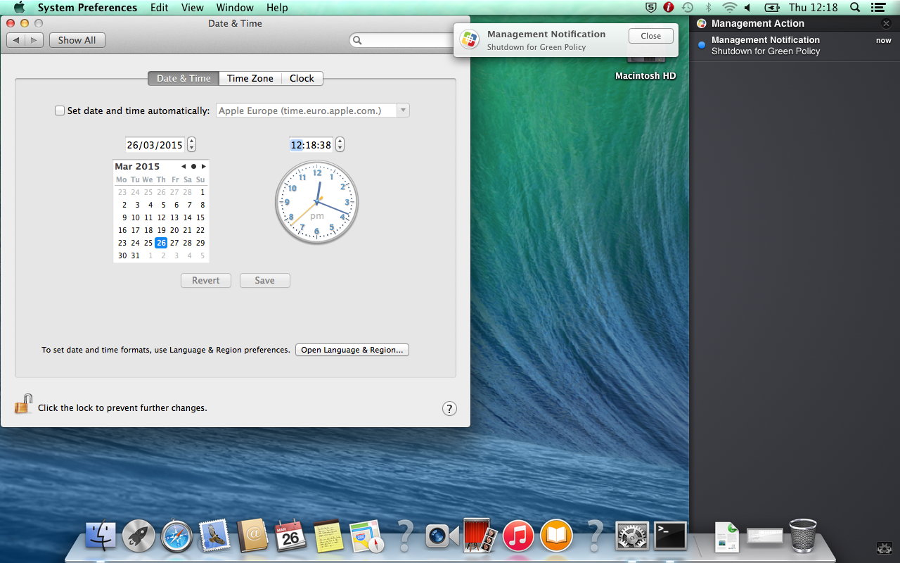

I love the idea of this script and it is perfect for what i need however i have a few issues and wandered if anyone can shed some light.
I'm testing on a MBPro 10.9.5 / Casper 9.63
I've uploaded the script to the JSS and configured a policy.
For testing purposes the policy is running Recurring Check-In/Ongoing
I can see it is running as the Notification centre displays the name of the policy. See attached image. I'm hoping this will stop when i set Client-Side Limitations.
The problem occurs when the client hits the time outside the business hours.
1. The only notification i get is in the notification bar This could easily be ignored, missed or cleared by the user.
2. The option to postpone never comes up so as soon as the policy is in scope and runs, the machine shuts down.
Has anyone seen this behaviour and found a fix?
Could it be something that's changed in OSX 10.9 compared to 10.6/7/8 ?
Any help greatly appreciated.
Thanks
