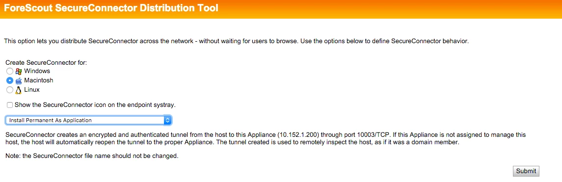

We're running Forescout - haven't had problems pushing the package out. I just tossed the .mpkg downloaded from the server into Casper Admin and created a policy to push it once per computer at check in.
Just make sure you are using the following options when downloading it from your Enterprise Manager server (important items are the "show the...icon" and "Install Permanent..."):

@johnklimeck The installer is provided as a DMG which contains a .app for the install. You can get it from your FS admins or you can grab it yourself if you know the IP address of one of your FS appliances or the FS Enterprise Manager. Typing https://{IP ADDRESSorHOSTNAME}/sc.jsp will get you to the page seen previously in this thread. From there you can download the standalone install package.
