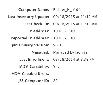

Have a student computer that hasn't checked in for a while. That machine has 9.73 while we are running 9.81 now. I would be happy to just input my ladmin password to get issue worked out using selfservice, but the ladmin password that was created during jumpstart was a random password (yup, bad idea). I know one time I used terminal to do things, but terminal is blocked app on student devices. The self service app shows up with updated apps, but will not execute any of them. I told the student there is one way that will for sure work, wipe machine, but I would prefer not to do that. Any ideas on how to get this to come back around?
I did notice that around 15 other student devices have same issue with not checking in since same date as well as same 9.73 version.
