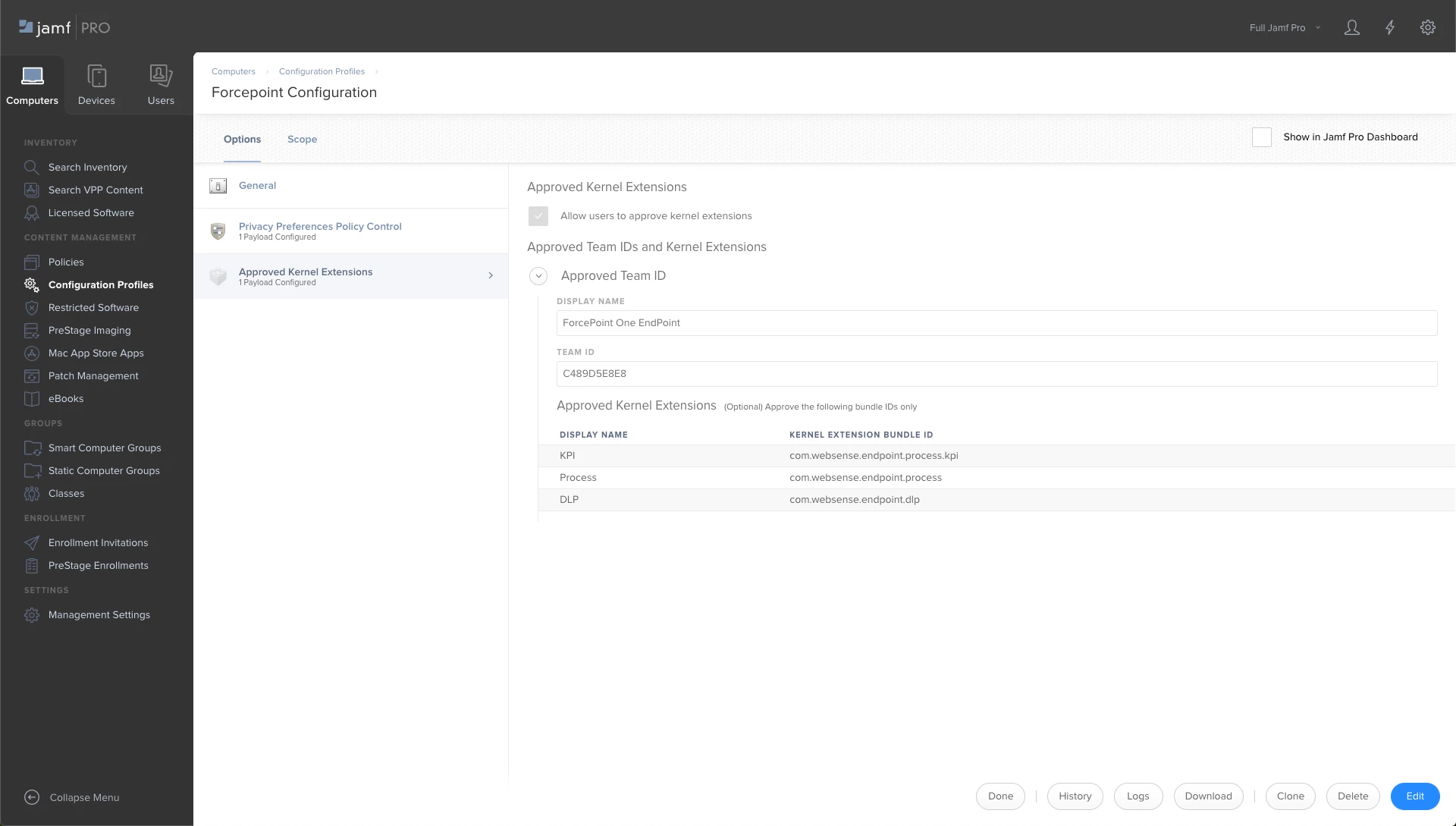

if you are just deploying the endpoint client, you just need to package the WebsenseEndponit.pkg. Other files are not required.
You will need to add a - Configuration Profile > Approved Kernel Extensions with Team ID C489D5E8E8 - Configuration Profile > Privacy Preferences Policy Control. I just need to know the CODE REQUIREMENT for it as I don't know it.

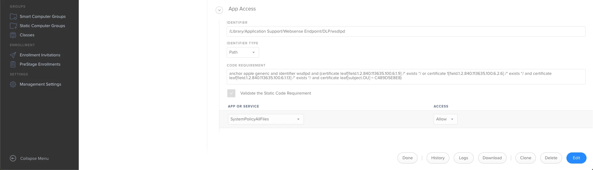

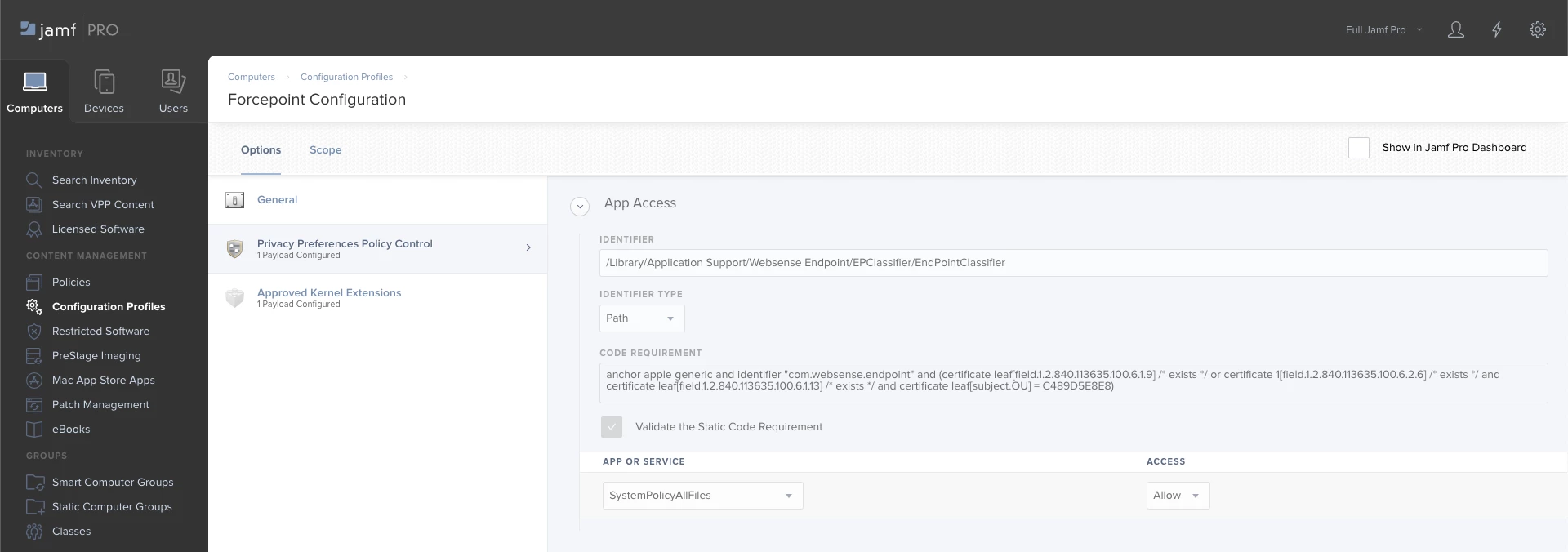

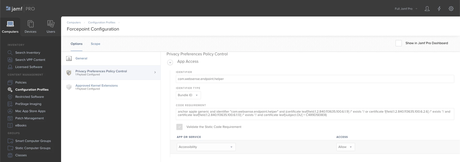

Forcepoint is kinda annoying, the application manufacturer makes the product for macOS but does not officially support it on macOS. We deploy the forcepoint installer and use a scrip to install it, and have a configuration profile to do everything needed for forcepoint to work. I attached screenshots of our configuration profile for forcepoint, and the script we use to install it. If this does not get you going you may need to get with forcepoint.
## postinstall
pathToScript=$0
pathToPackage=$1
targetLocation=$2
targetVolume=$3
tritonClassifier="/private/tmp/RGBK/Forcepoint_Endpoint_20.05/WebsenseEPClassifier.pkg"
tritonEndpoint="/private/tmp/RGBK/Forcepoint_Endpoint_20.05/WebsenseEndpoint.pkg"
#Install WebsenseEPClassifier.pkg
sudo installer -pkg $tritonClassifier -target / -allowUntrusted
#Install WebsenseEndpoint.pkg
sudo installer -pkg $tritonEndpoint -target /
#Wait 5 Seconds and deleted local installation files
sleep 5
sudo rm -rfv /private/tmp/RGBK/Forcepoint_Endpoint_20.05
exit 0 ## Success

@dshepp33
Even I'm late for the party but here you go the Code Requirements, not sure if you still looking for these 😄 😛
Team ID: C489D5E8E8
Bundle ID: com.websense.endpoint
1 Identifier:
/Library/Application Support/Websense Endpoint/EPClassifier/EndPointClassifier
Id type: Path
code requirement:
anchor apple generic and identifier "com.websense.endpoint" and [certificate leaf[field.1.2.840.113635.100.6.1.9] /* exists */ or certificate 1[field.1.2.840.113635.100.6.2.6] /* exists */ and certificate leaf[field.1.2.840.113635.100.6.1.13] /* exists */ and certificate leaf[subject.OU] =C489D5E8E8]
syspolicyallfiles - allow
static code validation: check mark
2 Identifier:
/Library/Application Support/Websense Endpoint/DLP/wsdlpd
ID type: Path
code:
anchor apple generic and identifier wsdlp and [certificate leaf[field.1.2.840.113635.100.6.1.9] /* exists */ or certificate 1[field.1.2.840.113635.100.6.2.6] /* exists */ and certificate leaf[field.1.2.840.113635.100.6.1.13] /* exists */ and certificate leaf[subject.OU] =C489D5E8E8]
3 Identifier:
com.websense.endpoint.helper
ID type: Bundle ID
Code:
anchor apple generic and identifier "com.websense.endpoint.helper" and [certificate leaf[field.1.2.840.113635.100.6.1.9] /* exists */ or certificate 1[field.1.2.840.113635.100.6.2.6] /* exists */ and certificate leaf[field.1.2.840.113635.100.6.1.13] /* exists */ and certificate leaf[subject.OU] =C489D5E8E8]
Accessibility: Allow
