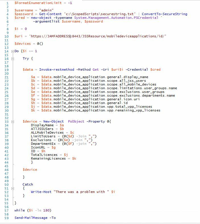

We had a powershell script (pictured) that would Get information about Mobile Device Apps and who they were scoped to so that we could use this data else where. After one of the recent updates it has stopped working.
Does anyone have any idea as to why this would be?

It looks like you're not specifying an Accept header, while Jamf Pro is capable of returning both XML and JSON, therefore you may be receiving XML or JSON when expecting the other. I don't know powershell well enough to know which you're expecting, but I'm guessing JSON, in which case line 19 should look something like the following:
$data = Invoke-restmethod -Method Get -Uri $uri$i -Credential $cred -Headers @{"accept"="application/json"}

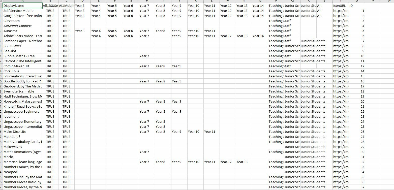

I normally run the below to run the script and output it to a csv file.
C:ScopedScriptsAppSyncAppSync.ps1 | Select-Object -Property DisplayName,AllJSSUsers,AllMobileDevices,LimitToUsers,Exclusions | Export-csv
I only have a csv file from when it worked which looks like the attached.

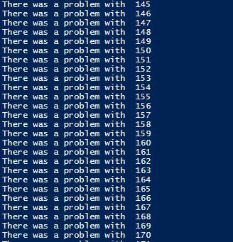

The output i get now is blank as this is all i get when i run the script.
