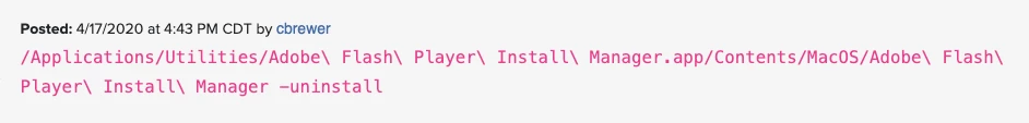

/Applications/Utilities/Adobe Flash Player Install Manager.app/Contents/MacOS/Adobe Flash Player Install Manager -uninstall
@cbrewer Yep, I actually found it in the Flash Player Admin Guide over the weekend. Though they direct you to download an "uninstaller," I extrapolated that the Adobe Flash Player Install Manager.app is already installed. I created a very simple script in JamfPro, and tested it out. Works like a charm. I'm very excited about this.
Care to share your script? Or is just basically the above one liner?
Adobe is now displaying an end of life page if someone goes to their website to download flash. The command posted by @cbrewer above will remove Flash. It prompts for a password, but if the command is ran as root, it won't. I wasn't thinking about the Flash Player Install Manager, so I wrote a script that removes every Flash component. Safari and Chrome both no longer support Flash. My understanding is that Firefox will stop supporting Flash in December.
I'm planning on a script / policy to be run from Self Service, so that would get root access. At least they are making it difficult to get so maybe it will actually die.

@swallace I did test it, but I've borrowed something from Rich Trouton because... well, everyone should borrow things from Rich. (https://github.com/rtrouton/rtrouton_scripts/blob/master/rtrouton_scripts/uninstallers/adobe_flash_uninstall/adobe_flash_uninstall.sh)
We used the built in unistaller seen above and had success. Removed without out issue. It was a Self Service item until the 31st then made it run at check in after that, since my users rarely do anything "optional".
