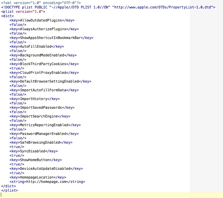

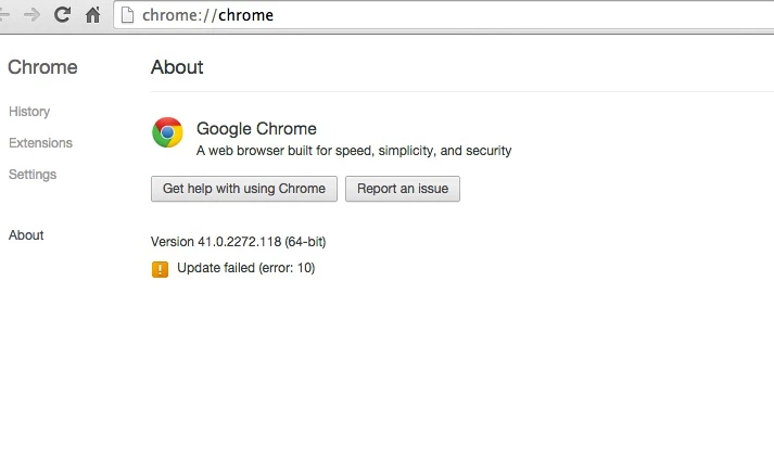

I added:
<key>DeviceAutoUpdateDisabled</key>
                                <true/>
to my configuration profile and updates will fail when the user clicks on 'Update Chrome'. It also stopped Chrome from autoupdating.
My new issue is how can I suppress the yellow bar saying "Google chrome might not be able to keep itself updated" during first launch?
  • April 21, 2015
Thanks - but that didn't stop the update - Here is what I have:

@Abdiaziz - in my testing with config profile set to DeviceAutoUpdateDisabled to true, it still tries to run the GoogleSoftwareUpdate.bundle on launch of the app. The chromium site only mentions support for Chromium on this, not OSX, not sure if that's why
if I go to Chrome://policy it doesn't show that setting coming down, though it is listed in the plist in HD/Library/Managed prefs - think it doesn't apply to OSX unfortunately.
