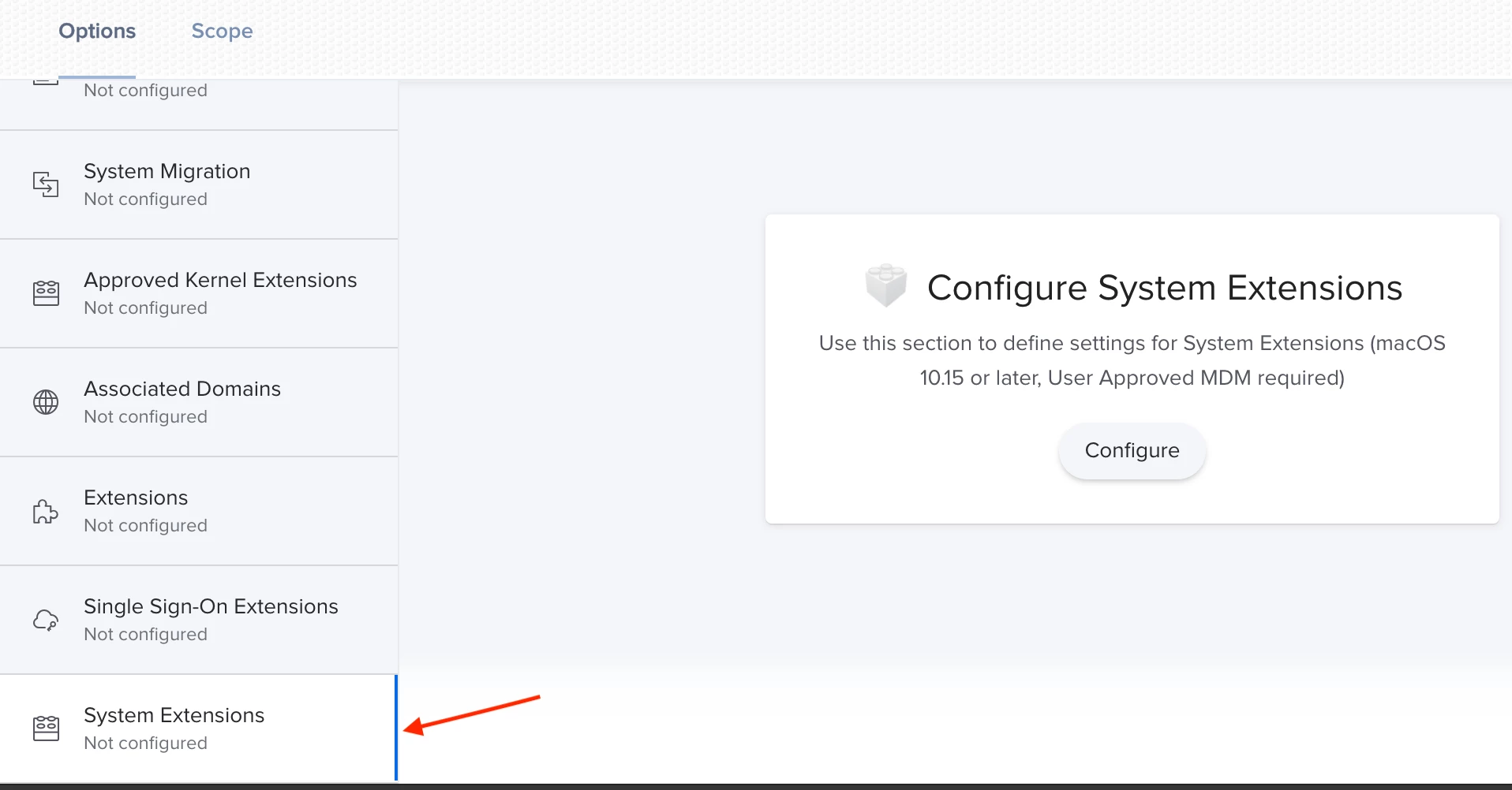

@quip_MDavison Try switching from a Kernel Extension to a System Extension payload for your Configuration Profiles.. Big Sur moved to System Extensions.. You may or may not have to enable the particular Allowed System Extension Type

@JustDeWon Yeah, that's what we're trying to do. Unfortunately when I install the GDFS app to try to pull the proper system extension IDs instead of what we used for the kext it reports that there arent any system extensions installed on the system at all so I can't get the proper IDs to put in the policy.

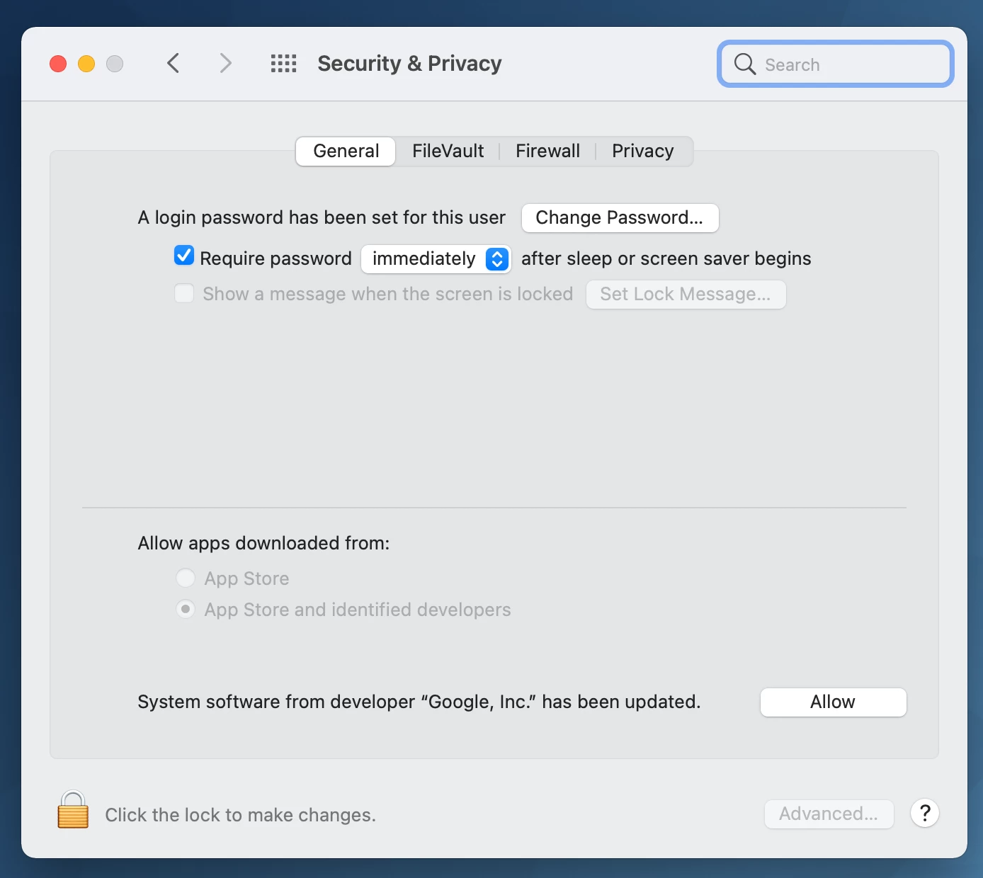

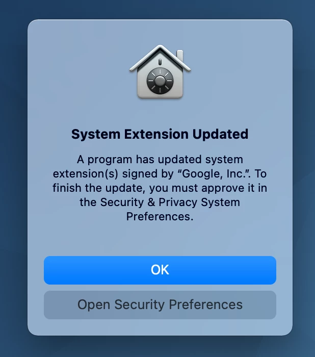

@nstrauss That's unfortunately not the behavior we're seeing. Even when installing the app on an intel macbook with Big Sur without JAMF, users are being prompted to approve a system extension for GDFS, not a kernel extension (unless the apple dialogue box is a liar which is very possible). But after approval no system extension is actually registered with the system (but the app works). Our existing Kernel Extension config profile as well as the System Extension policy we're testing for GDFS have "allow users to approve kernel extensions" enabled but in both cases it does not work on Big Sur, an admin still must manually provide credentials to approve installation.

@quip_MDavison Yes, the dialog box lies. Apple refers to kernel extensions as system extensions in approval dialog. GDFS contains no system extension. The system is prompting to allow the kernel extension. Yes, this is confusing. No, Apple has not been receptive to that feedback.

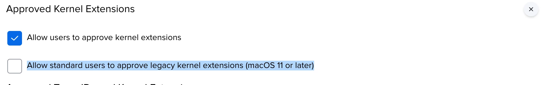

Make sure the box for "Allow standard users to approve legacy kernel extensions (macOS 11 or later)" is checked. That feature is only available in Jamf Pro 10.26 I believe and is different than only "Allow users to approve kernel extensions." Also keep in mind that profile must be installed after a Mac is on Big Sur. It can't be preinstalled on Catalina for instance.
Standard users can then allow/approve the kernel extension themselves and restart when prompted. Be sure they restart through prompt in System Preferences > Security & Privacy and not Apple > Restart... as my experience has been the kernel cache is not updated that way.

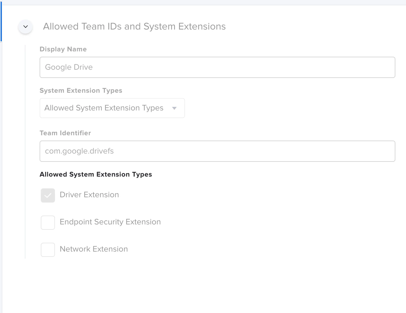

  • February 9, 2021
No. I still haven't figured it out. After a clean Big Sur install I get the popup. With version 45, I DO get the option to manually approve (didn't get the option with old version)

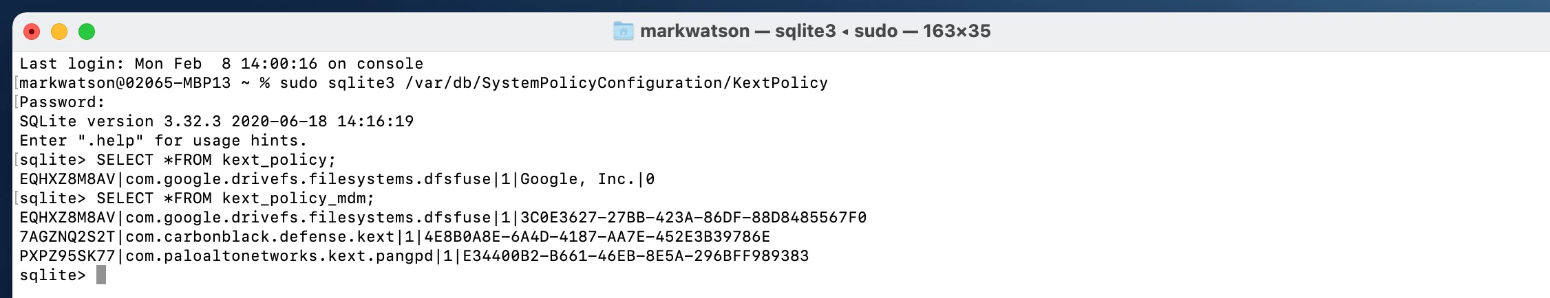

Here is a screen shot of the mdm config, and the manual approval.
No clue.

  • June 15, 2021

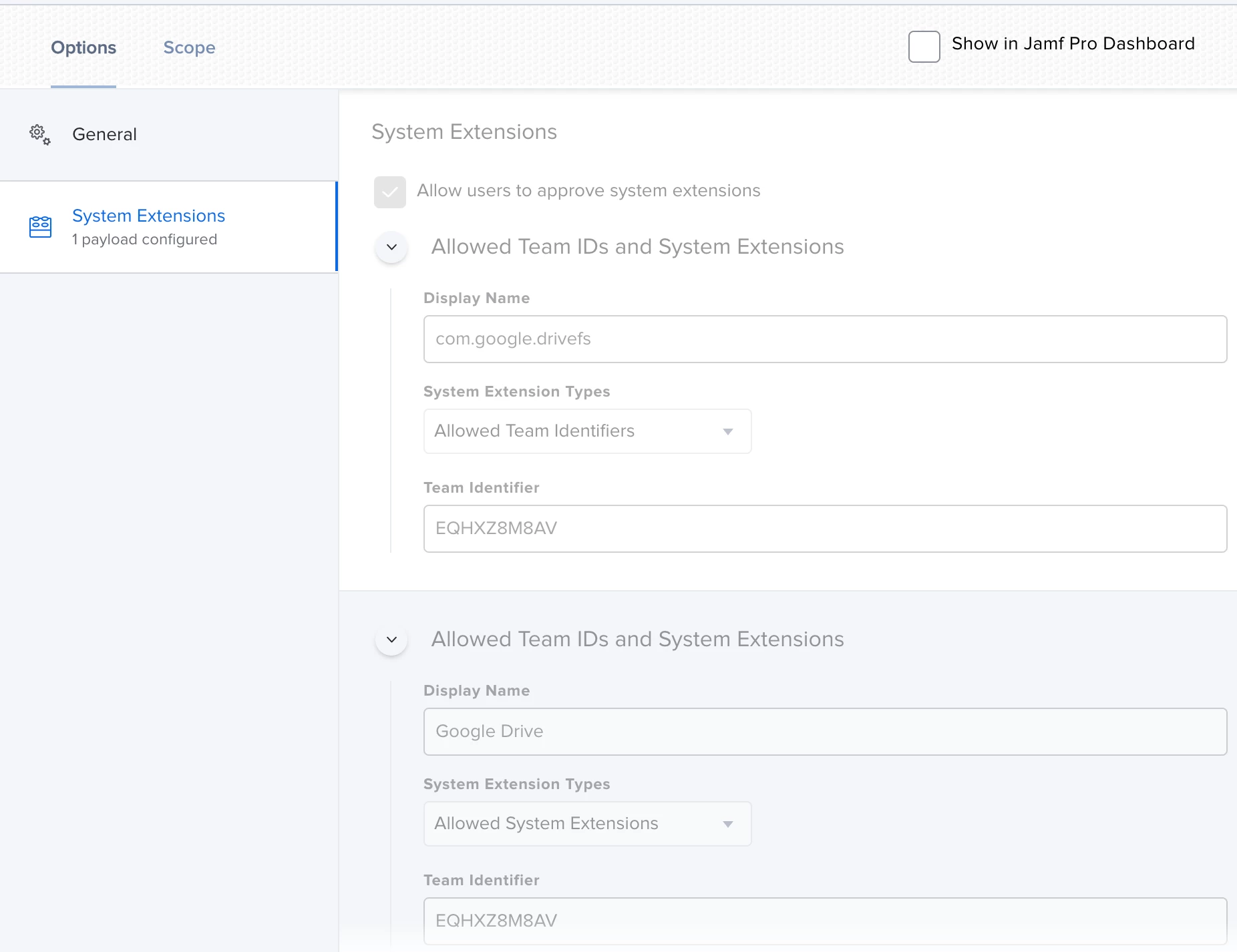

Oddly enough I have Google Drive Working in Big Sur with M1, however this does not seem to take for intel Macs on Big Sur, so Odd.
Screenshots below, we also had a separate package that installs the root cert for our org, and a defaults write script to point it to the cert if that helps anyone.
Going to keep working on this for the Intel machines, all works except the bit where only on intel it states "System Extension Blocked" and prompts to "Open Security & Privacy Settings" to approve.
Again, seriously perplexed at why this does not happen on the M1 machines!

Any luck at getting Google Drive for Desktop to install on Intel machines without the ""System Extension Blocked" and "Open Security & Privacy Settings" to approve"  window?
I have added the appropriate lines to the System Extensions profile as outlined in this thread and have Google Drive installing without user prompt on M1 machines. I just can't get around the admin user prompt on Intel Machines (running Big Sur).
