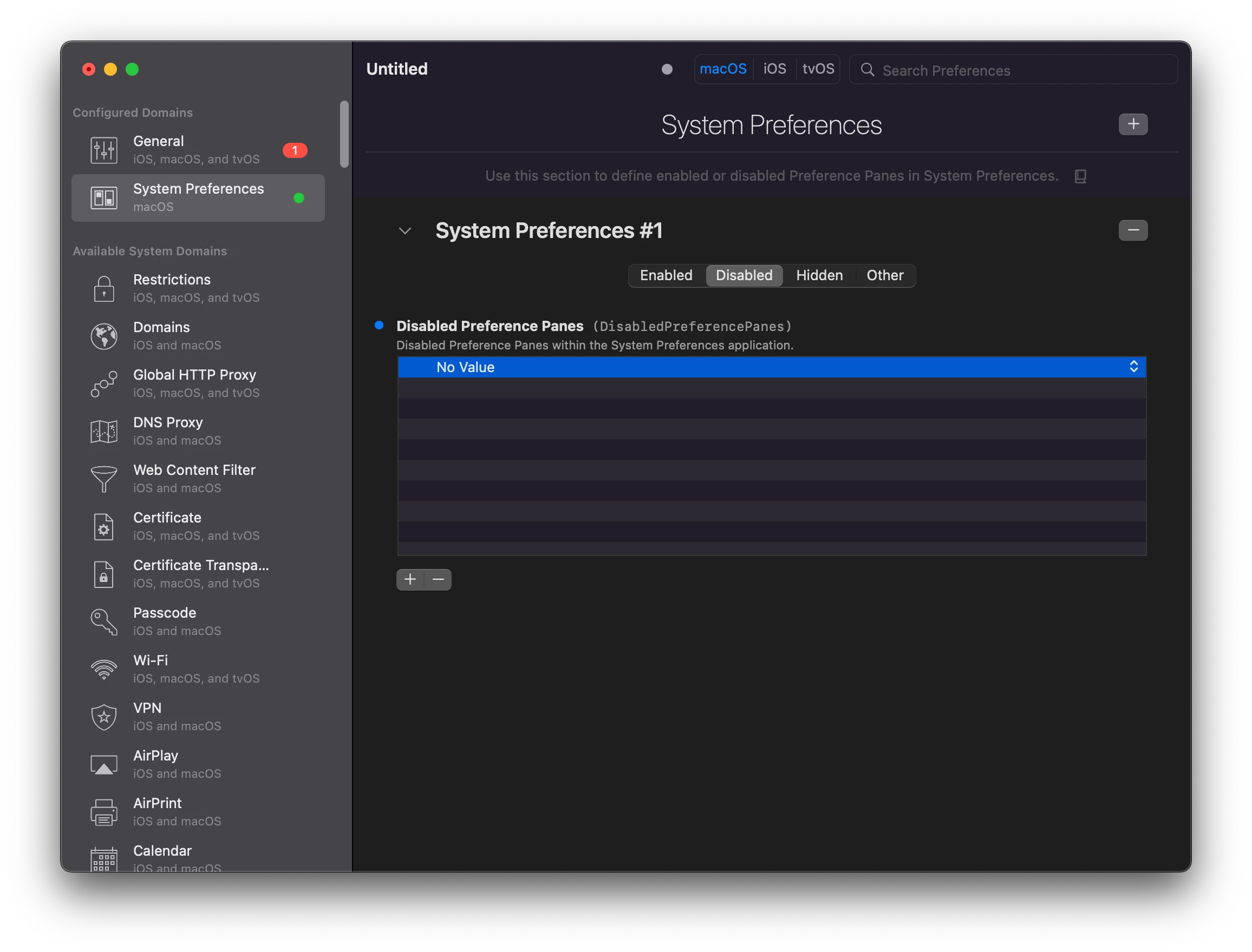

Hi all,
I am trying to find the plist that I can target to restrict Nessus Agent from being clickable in System Prefs. Any ideas?

iMazing Profile Editor (https://imazing.com/profile-editor) has Nessus Built in as an option you can select under the restrictions payload to disable the preference pane

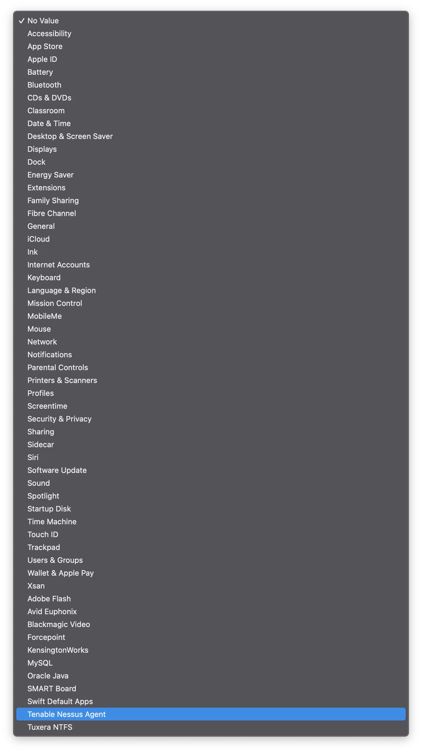

In the System Preferences Payload. When you click the dropdown for which to disable, its the second from the bottom
