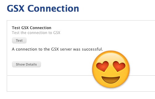

I'm getting this error when testing the connection to GSX.
"AUTH.UPL.003: Invalid URL for this SoldTo."
Where can I find the right URI for my soldto?
Just thought I'd post this to help others out...
The URI that I am successfully using with the "GSX New Generation WSDL" (Certificate Based) is:
https://gsxapi.apple.com/gsx-ws/services/am/asp
Horrible documentation. Took me forever to find, so I hope it helps someone else avoid that hunt!
Posted: 1/26/16 at 2:23 PM by bkerns Just thought I'd post this to help others out... The URI that I am successfully using with the "GSX New Generation WSDL" (Certificate Based) is: https://gsxapi.apple.com/gsx-ws/services/am/asp Horrible documentation. Took me forever to find, so I hope it helps someone else avoid that hunt!
Thanks! This is exactly what I needed. I was getting that darn "AUTH.UPL.003: Invalid URL for this SoldTo." error too.
@howie_isaacks Thanks! Worked a charm.
