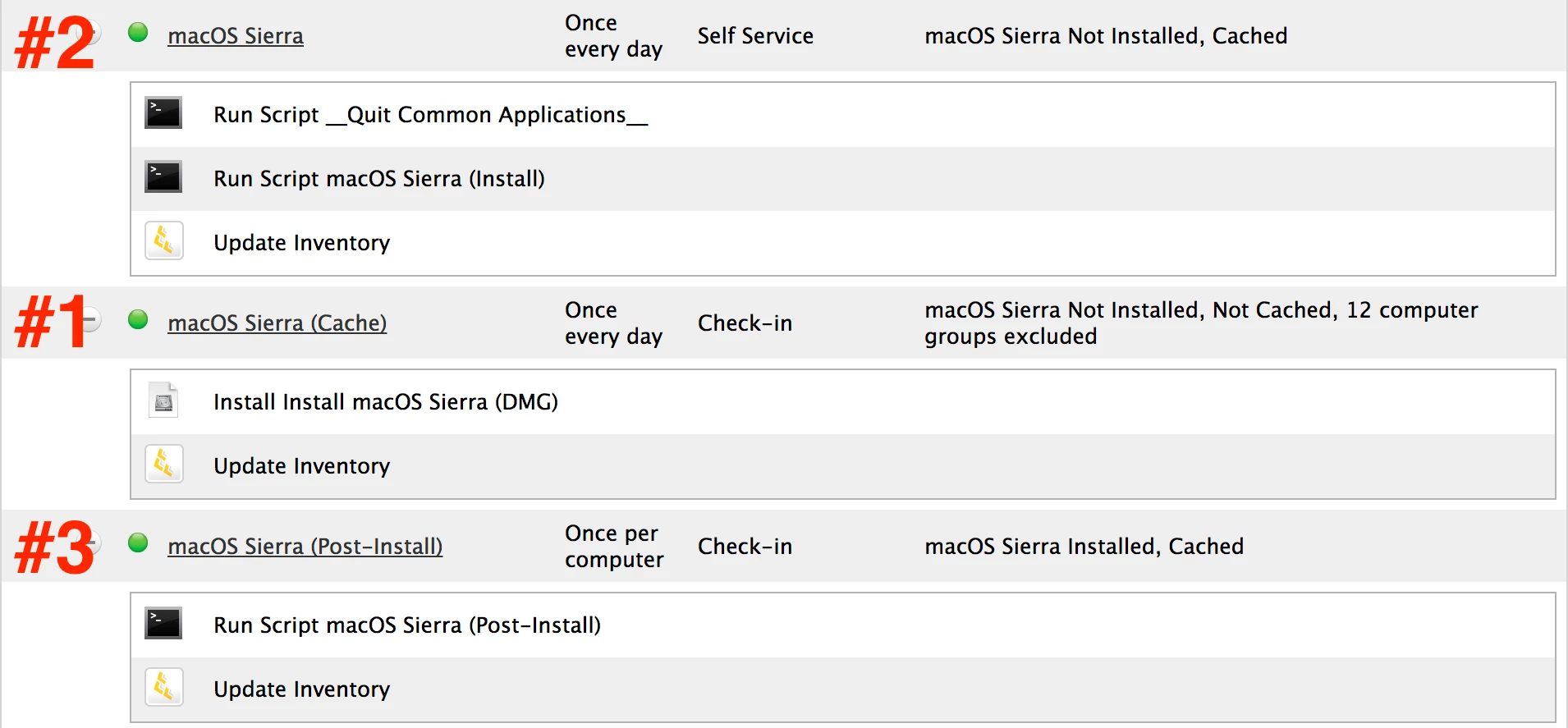

I've used the Jamf approach mentioned by @tak10 in the past but have since adopted @Rosko's workflow (with some slight modifications). @Rosko's approach can be found here.

@DanJ_LRSFC @Rosko's method works for 10.10! I imagine it'll work for earlier releases as well and plan to test it on 10.9 today. We don't have too many legacy macOS devices so I am only concerned primarily with 10.10-10.11.

While @Rosko's post-install script is probably infinitely better, I have include the following into my organization.
#macOS Sierra (Post-Install) Script:
# Remove "Install macOS Sierra.app" installer from /Users/Shared/.
rm -rf /Users/Shared/Install macOS Sierra.app;
exit 0;

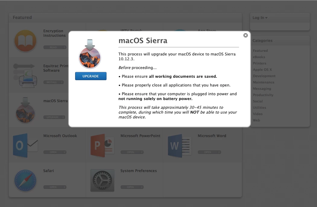

I am sure that there are much simpler methods to achieve the same goal but this is working for my organization. I prioritized closing browsers and Office 2016 and added Slack and iTunes as they're sluggish. It's worth noting that in my Self Service description (set that users have to view it), it states that all work should be saved, blah, blah, blah. You can even use Automator (/Applications/Utilities/Automator.app) to create a custom app that closes EVERYTHING except Self Service for instance.

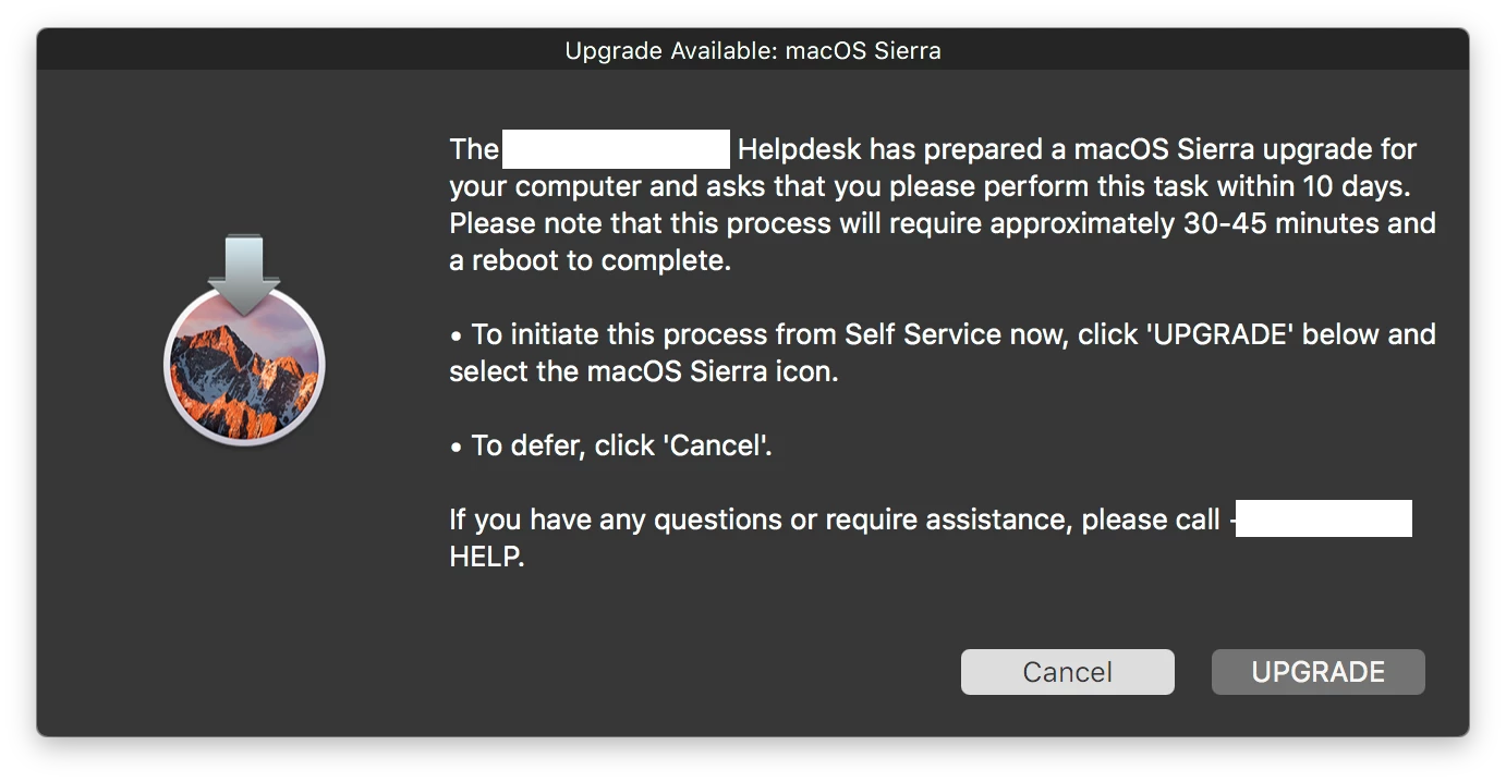

Thanks, @__Uss! I've even added a jamfHelper notification for users running once daily to encourage the upgrade.

@sepiemoini
would you mind sharing your jamfHelper notification to encourage the upgrade.
  • October 24, 2017
@sepiemoini Id also like to see that JAMFhelper code for the above.
Cheers!
  • October 24, 2017
@sepiemoini Nice work on the jamfHelper notification. I would love to take a look at your code as well.
