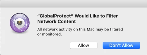

Does anyone have information regarding a Content Filter for Global Protect? I want to prevent the filter prompts that appear during installation.
franton
  • Jan 11, 2021 4:37 PM UTC
As far as i'm aware GP isn't installing a content filter, even on latest 5.2.4.
bwoods
  • Jan 11, 2021 4:52 PM UTC
@franton I'm currently testing Global Protect 5.2.4 on 11.1 and during installation I'm receiving Content Filter prompts that disrupt DEPNotify. Palo Alto provided 4 configuration profiles to get around this issue in addition to the System Extension/Kernel Extension/PCC/Notificaion profile that you need to configure yourself. One of the provided profiles does not install if you are running Jamf Cloud version 26 due to a Jamf Pro issue. Jamf says that the issue should be resolved in the next release.
You may also not see this if your GP Protect Admins have turned specific features such as "Enforcement" off.

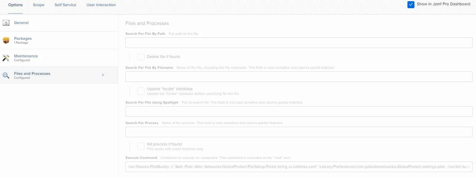

  • Jan 20, 2021 2:21 PM UTC
I have recently configured for my environment and this solution worked perfectly.
Policies > Files and Processes
Execute Command
/usr/libexec/PlistBuddy -c "Add :Palo Alto Networks:GlobalProtect:PanSetup:Portal string servername" /Library/Preferences/com.paloaltonetworks.GlobalProtect.settings.plist ; /usr/bin/su - "/usr/bin/stat -f%Su /dev/console" -c "/usr/bin/pkill -l -U /usr/bin/stat -f%Su /dev/console GlobalProtect" ; /bin/sleep 3 ; /usr/local/bin/jamf recon
Post installation, it updates the server name and works great.

  • May 14, 2021 2:52 PM UTC
@Saikat I get an error when running that command.
Running command /usr/libexec/PlistBuddy -c "Add :Palo Alto Networks:GlobalProtect:PanSetup:Portal string myvpn" /Library/Preferences/com.paloaltonetworks.GlobalProtect.settings.plist ; /usr/bin/su - "/usr/bin/stat -f%Su /dev/console" -c "/usr/bin/pkill -l -U /usr/bin/stat -f%Su /dev/console GlobalProtect" ; /bin/sleep 3 ; /usr/local/bin/jamf recon...
Result of command:
su: unknown login: /usr/bin/stat -f%Su /dev/console
@Jamie.Boyd you made a mistake in the command. Please see the command line below.
