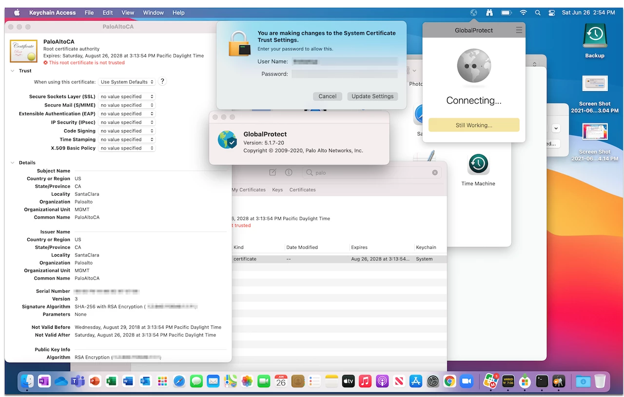

Anybody else seeing GlobalProtect 5.2.5-84 triggering a "You are making changes to System Certificate Trust Settings" authorization prompt at the first connection attempt after initial install (so @franton's removal of the GPService keychain isn't applicable) on Big Sur systems?
@sdagley so it sounds like you are talking about something I encountered in 5.1.7 (see screenshot). We opened a case wit PA and they came back with Apple's macOS Big Sur 11.0.1 Release Notes (not realizing the intended audience is the vendor not the end user). It states:
Security
New Features
         macOS Big Sur 11 beta improves system security by requiring an administrator password when a certificate trust settings change is made in the admin trust domain. Running as the root user alone is no longer sufficient to modify certificate trust. User trust domain settings continue to require confirmation by entering the password for the user’s account. This change may affect you if one of the following is true:
o    You have written scripts which call /usr/bin/security add-trusted-cert -d ... as root.
o    Your process runs as root and calls the SecTrustSettingsSetTrustSettings function to trust a certificate.
         Workflows that add trust settings in the admin trust domain, such as for an enterprise root certificate, may require modification if the user can’t authenticate as an administrator at the time settings are changed. (21855995)
Workaround: Use Apple Configurator 2 to create and install a configuration profile containing your root certificate.
Our ask of PA:
Proposed Solution: For PA to use Apple’s suggested workaround. One of the following solutions should suffice:
  1. Provide a signed configuration profile containing 1 payload: the required root certificate
  2. Provide the required root certificate to be used in our own signed configuration profile
Then they came back and said they don't provide those solutions or file types. And I then replied with their own KB where they do in-fact offer config profiles and instructions on how to create them. and then reiterated...
Palo Alto is performing an action where scripted actions that are no longer supported by Apple due to increased security. The provided workaround for the vendor is clearly stated and should be provided to their customers by one of the two methods discussed already.
Interestingly in our 5.2.8 testing, we have not seen this prompt for the system level cert. So maybe they fixed this?
Security
New Features
Our ask of PA:
@TechM I never followed up my post in this thread, but I solved the problem by extracting the PaloAltoCA certificate from a Mac that had already connected via GlobalProtect, and then added a Certificate payload with that certificate to the Configuration Profile we deploy to approve the GlobalProtect System Extension.
As for why you didn't see the cert prompt with 5.2.8, had those Macs previously connected with any other version of GP? I don't believe that cert changes between client versions, but will depend on GP host server.

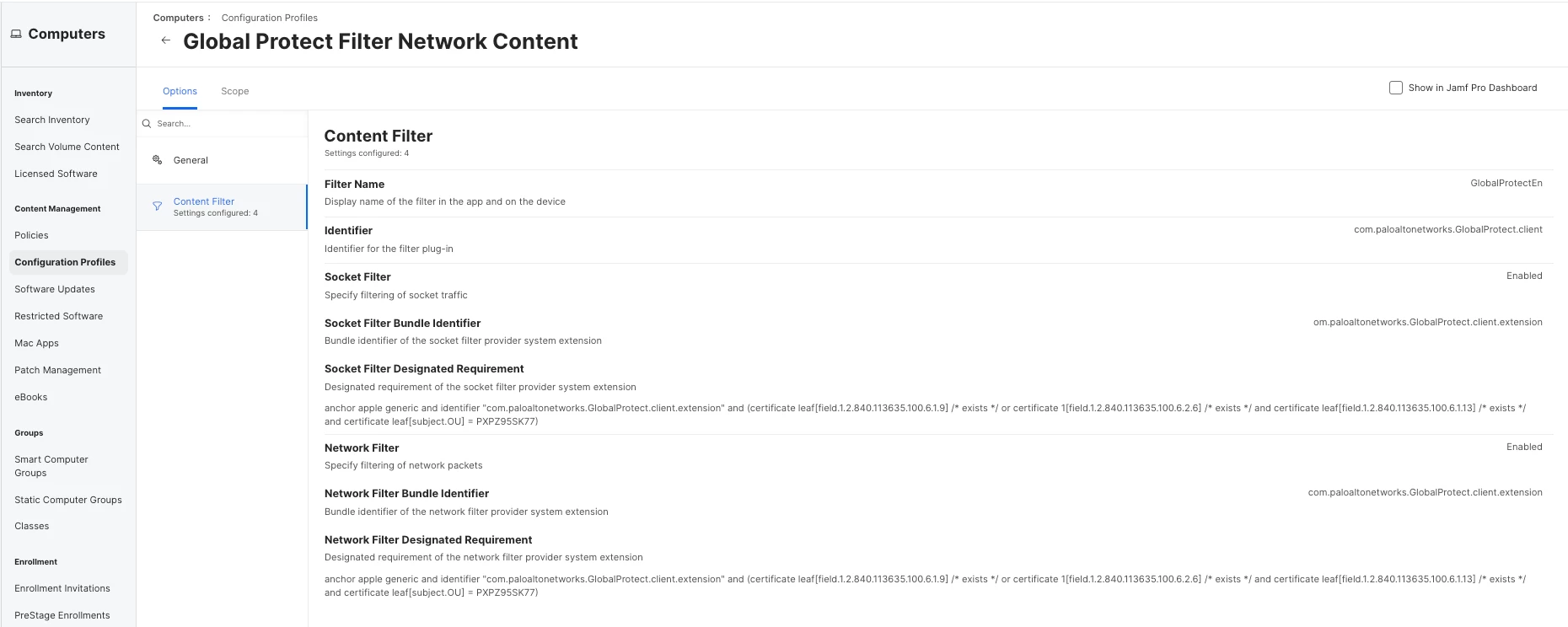

@franton I'm currently testing Global Protect 5.2.4 on 11.1 and during installation I'm receiving Content Filter prompts that disrupt DEPNotify. Palo Alto provided 4 configuration profiles to get around this issue in addition to the System Extension/Kernel Extension/PCC/Notificaion profile that you need to configure yourself. One of the provided profiles does not install if you are running Jamf Cloud version 26 due to a Jamf Pro issue. Jamf says that the issue should be resolved in the next release.
You may also not see this if your GP Protect Admins have turned specific features such as "Enforcement" off.
Hello @bwoods , I think this is what you are looking for.
  1. Select Content Filter from the options and configure the following values and save the configuration profile.
  • FilterName = GlobalProtectEn
  • Identifier = com.paloaltonetworks.GlobalProtect.client
  • Socket Filter Bundle Identifier = com.paloaltonetworks.GlobalProtect.client.extension
  • Socket Filter Designated Requirement = anchor apple generic and identifier "com.paloaltonetworks.GlobalProtect.client.extension" and (certificate leaf[field.1.2.840.113635.100.6.1.9] /* exists */ or certificate 1[field.1.2.840.113635.100.6.2.6] /* exists */ and certificate leaf[field.1.2.840.113635.100.6.1.13] /* exists */ and certificate leaf[subject.OU] = PXPZ95SK77)
  • Network Filter Bundle Identifier = com.paloaltonetworks.GlobalProtect.client.extension
  • Network Filter Designated Requirement = anchor apple generic and identifier "com.paloaltonetworks.GlobalProtect.client.extension" and (certificate leaf[field.1.2.840.113635.100.6.1.9] /* exists */ or certificate 1[field.1.2.840.113635.100.6.2.6] /* exists */ and certificate leaf[field.1.2.840.113635.100.6.1.13] /* exists */ and certificate leaf[subject.OU] = PXPZ95SK77)
