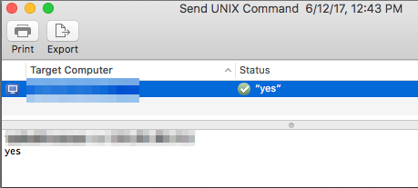

When I run it through ARD, I get a "yes" from computer that has the Lightspeed Mobile Filter installed. I created the extension attribute in our JSS, but none of the computers are reporting back.

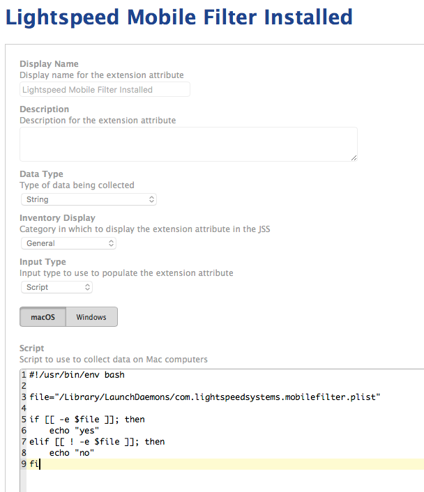

I used Data Type: String, Inv Display: General, Input Type: Script

@jgrubbs You need to wrap your echoes with <result></result> tags for EA responses.
  • June 12, 2017
@StoneMagnet like this:
if [[ -e $file ]]; then <result>echo "yes"</result>
elif [[ ! -e $file ]]; then <result>echo "no"</result>
  • June 12, 2017
@jgrubbs Almost, you need put those tags inside your echo like echo "<result>Some response here</result>". What you return inside those tags is what the JSS displays for the EA response.
donmontalvo
Forum|alt.badge.img+36
  • June 12, 2017
Not sure elif or double brackets is needed, how about?
file="/Library/LaunchDaemons/com.lightspeedsystems.mobilefilter.plist"
if [ -e $file ]; then
    echo "<result>yes</result>"
else
    echo "<result>no</result>"
