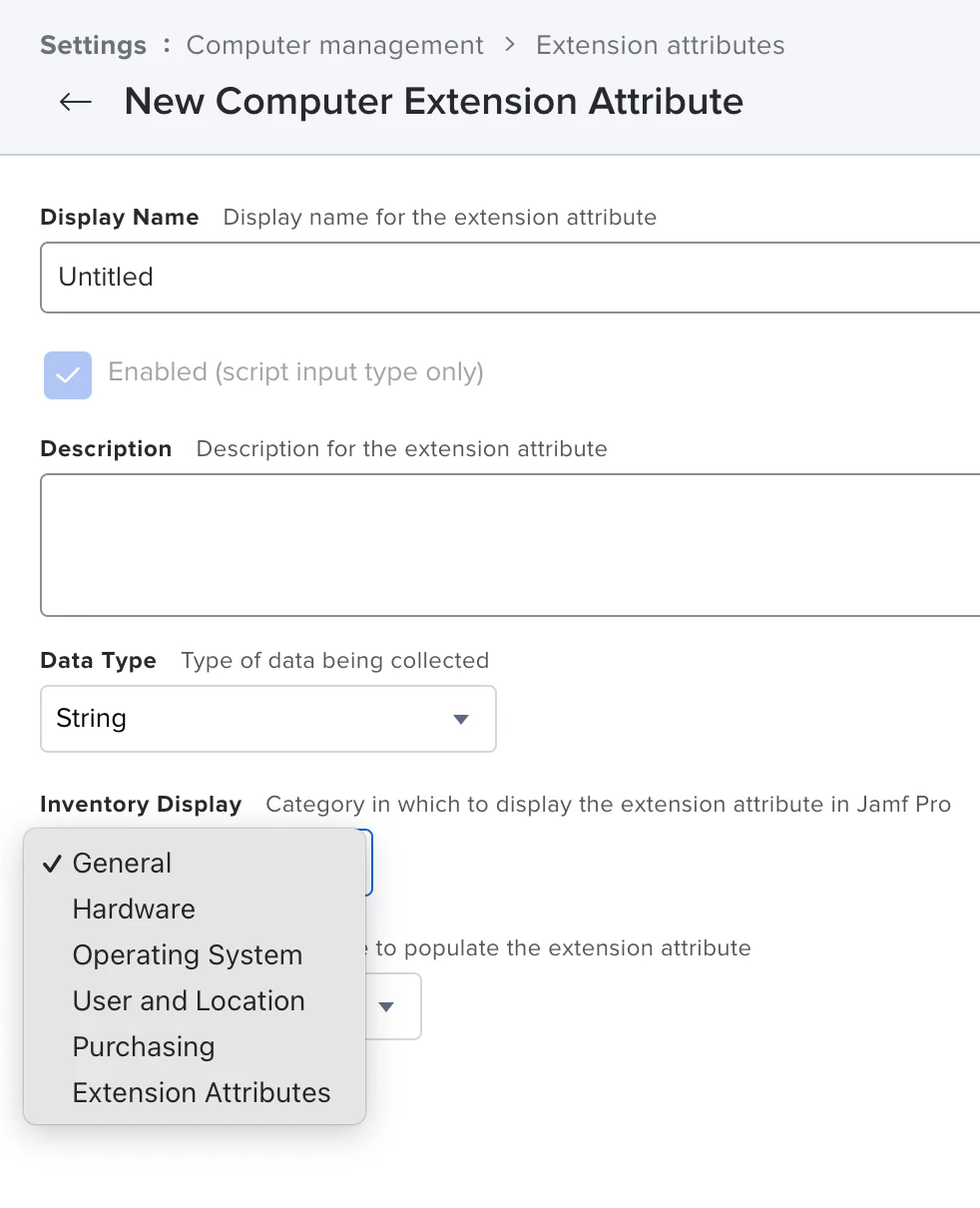

is there a possibility to display an extension attribute either separately at another place or to hide the attribute and make it visible by mouse click? It is about the fact that we have a script in use that implements LAPS - so assigns a local admin password and stores it in an attribute for emergencies. But I don't want this to be visible directly, but that you have to click on it first to make it visible, at least similar to the recovery key. Is that possible?

@mickl089 No, you can pick several different locations to display an EA, but not obfuscate it.

@sdagleyThank you, where exactly do I have the option to display this everywhere? Currently, I only see the EAs in the device information at the bottom.

The available locations to display EA results are shown in @jtrant 's post.

Thanks, the idea is really great! Thanks also to the tip to display the EA somewhere else!
