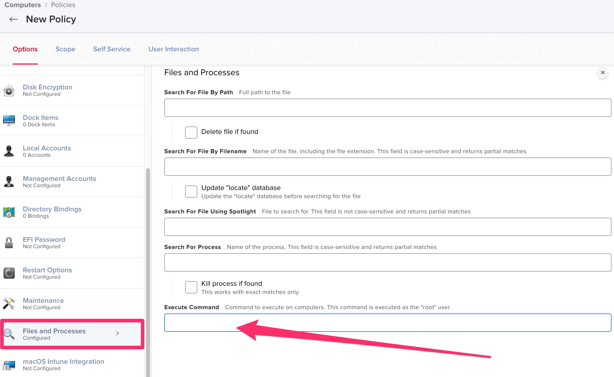

You can run a postscript or something to hide your local admin account from the GUI. It'll still be available to you when you log in with the username/password.
https://support.apple.com/en-us/HT203998
  • April 6, 2022
I see, but is there a way to hide them both from users & groups in system preferences and also at login window?
mvu
Forum|alt.badge.img+22
  • April 6, 2022
Yes, that command should do both. (I mean you can still log in as an admin even tho it's hidden from log-in window.)
Test. You can put that one-line command in Jamf's payload "File & Processes."
