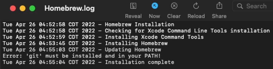

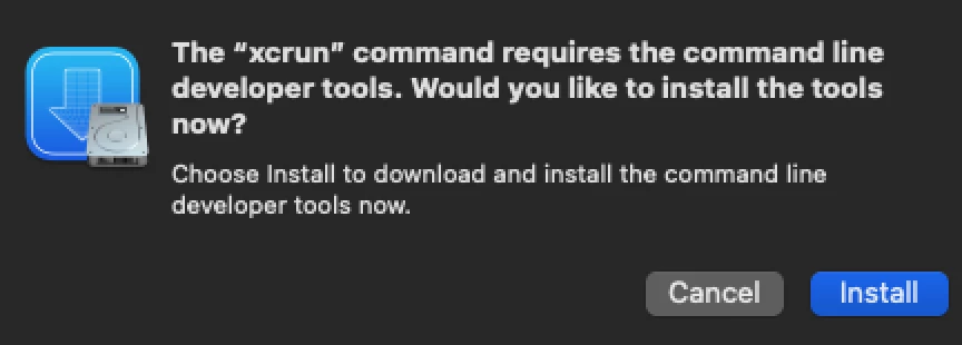

@honestpuck I tried your install script out on a VM that I have. I ran it from Self Service with a user with Admin Rights (still need to try a standard user yet). I got a couple popups.
When I clicked Install I got this:
When I checked the logs I saw this:
Any ideas on what I did wrong?

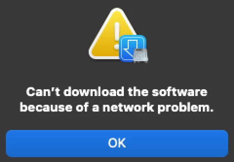

Yes, before we can install Homebrew we need git. The best way at this stage to get git is to install Apple's Xcode CLI tools. That's what the normal Home-brew installer does when you just run it, it checks and if necessary downloads the tools.
You had a network problem during the download of the tools and everything failed from then.
Are you running anything in the VM or on the host Mac that might stuff up the network? It's pretty easy to do with a VM - look at it wrong and the network fails to do something.
I would first snapshot, then do a "proper" install using Homebrew's ordinary method (since you have admin rights) and see if that works. If that works then roll back and try my script from an admin, if that works roll back again and try it without admin rights.

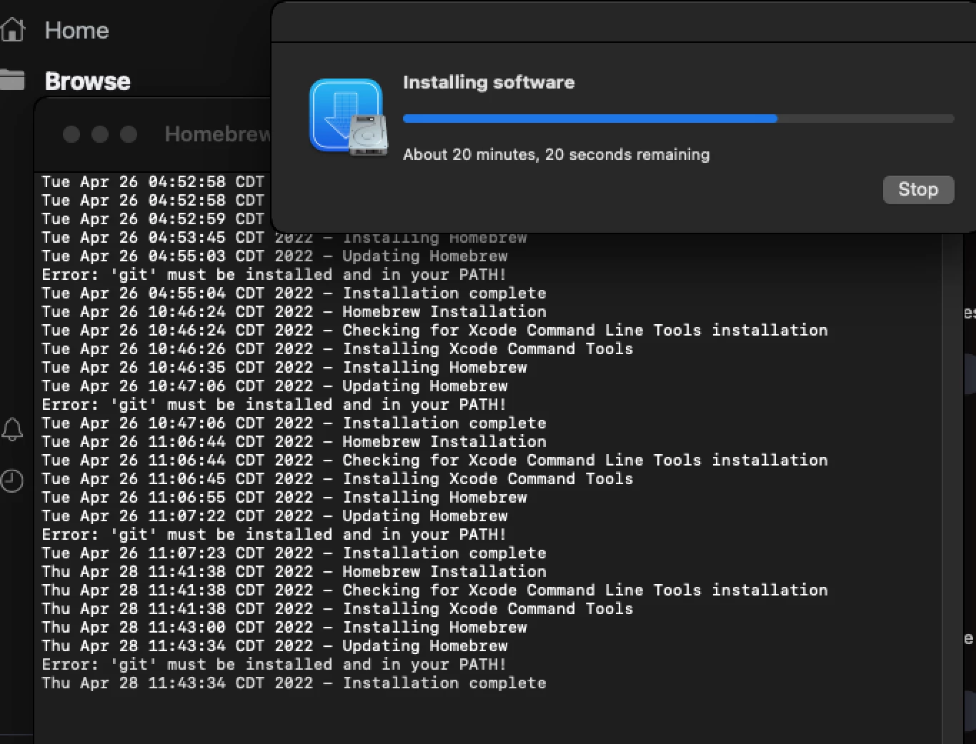

  • April 28, 2022
@honestpuck I reached out to my Security team to rule out something was being blocked on our Firewall. I reran it again on the VM and found that this time it was actually attempting to download/install the tools even though the script finished before the install did - see below. NOTE: This was over a VPN connection.
I reran the policy, this time on a test Mac connected via VPN and with a standard user with no Admin rights - everything installed correctly without any issues or prompts. The weird thing was on my VM it appears that Homebrew was attempting to upgrade where on my test Mac it didn't have to upgrade. The log file said it was already up to date. Not sure the reason for the differences but I won't be deploying to VMs so I'll take it as a win! Going to test on a couple other physical test Macs to confirm it works. Thank you!
