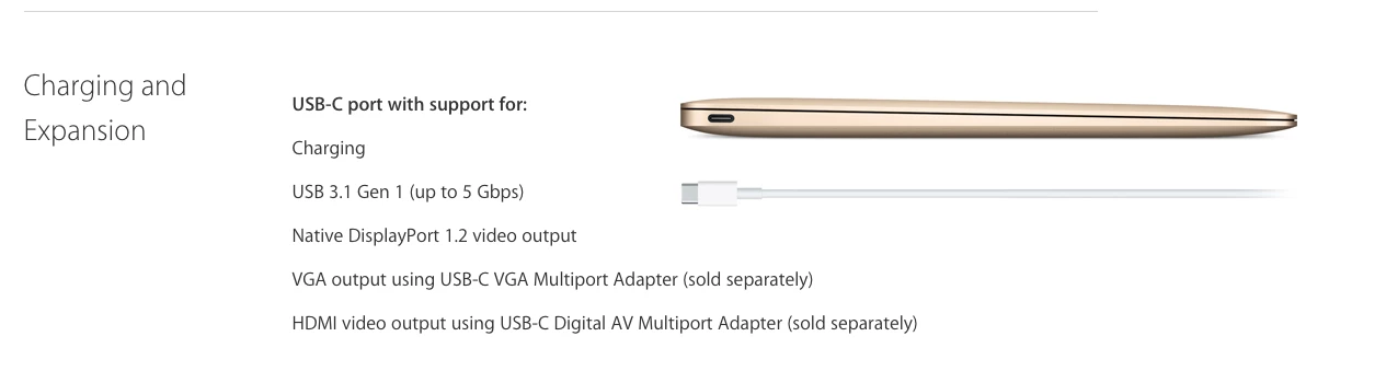

The connector is USB-C, but the bus is USB 3.0. So, it's not going to be like using a 5 year old USB 1.1 5400rpm hard drive or anything.
Not ideal, but not a total nightmare.
Apple also have USB-C to USB adaptors ($19), but their USB to Ethernet adaptor is still listed as 2.0... which is not ideal. Looks like a local USB 3.0 boot drive is the way to go for now.
Well the apple usb-ethernet adapter is only 10/100Base-T so yeah it will suck.. bad.
Admittedly, I'm holding out hope that there will be a better adaptor. However if each machine really can operate at 100 Mbps then it can still be acceptable. Then again, I've never seen a usb adaptor run at thise speeds...

Read this summary of USB-C and learned its 10Gbps. That's twice USB 3.
http://www.wired.com/2015/03/usb-type-c-faq
The more I think about the "Macbook" the more I think about it as a home or personal computer. Not a business machine.
@cwaldrip Probably wouldnt really believe much that is written on Wired TBH
Straight from the horses mouth: ie Apple.
Again, I really don't think that the USB-C standard here will cause any speed issues at all. I am a little surprised that thunderbolt didn't make it here, I can see USB-C as the standard for "iOS" devices moving forward. That could be interesting. However, it all goes back to the adaptors. If a new USB-C adaptor can run a USB 3.1 speeds then we're A-OK. At the moment I don't see any sort of adaptor form Apple. The closest thing is their USB-C to USB (or one of the other USB-C Adaptors with a USB port) which you'd have to plug a standard USB to ethernet adaptor into. That's not going to be pretty in any event.
The USB-C to AV adaptor has another USB-C 'link' port. This can be utilized for charging during any type of transfer. If I could get something like a USB-C to Ethernet adaptor WITH power I would be in a far better situation that I am with the current MacBook Air's during mass imaging. I'm particularly interested in this because I would put good money on the fact that I'll have a flood of students with these next year.
Again, this is going to be all about the adaptors... again.
@calumhunter ah. Maybe the spec can go up to 10Gbps, but Apple is choosing to stick with 3.x. Interesting.
