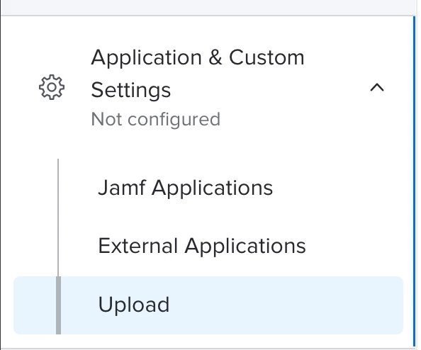

if you're working with an .xml file then I suspect the intention is to load that via a configuration profile to enforce those settings.  you would format it as a property list, and assign it to the com.org.whatever you're trying to manage.
