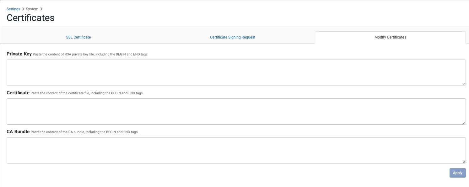

How does one apply SSL certs to a NetSUS box? I am not quite sure where to install them so I wanted to see if anyone had a step-by-step or documentation on how to do this?

Hi,
You can go to Settings -> System -> Certificates
Here you can create a CSR or you can manually insert a certificate under the pane "modify certificates"
Ensure you insert the full chain of certificates so root / sub and so on.
Cheers,
Thijs.

Thanks @txhaflaire ! I was thinking we can apply the certs from terminal but I guess it has to be done through the GUI?

@SlidewaysF30 Exactly through GUI.

So I think I am running into a bigger issue here....When I try to apply the certs, I get "Invalid Private Key"...What I found out is that when the CSR was created, it was done through the backend with openssl. Does the CSR need to be created through the NetSUS GUI in order for the certs to apply?
I have four files that I was given by our Network team, who handles obtaining certs, and they are as follows: ServerCertificate.crt, ChainBundle.crt, .pem, and .csr.
I placed the .pem file contents in the "Private Key" field. The ServerCertificate.crt file contents were placed in the "Certificate field" and the ChainBundle.crt file contents were placed in the "CA Bundle" field.
  • January 23, 2020
Turns out that the private key was in the wrong format that NetSUS accepts, so converting it from .pem to .key was the solution.
