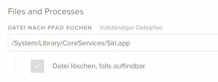

  • April 12, 2018
I have trouble with deactivate Siri.app, too. I try many things but nothing work fine for me, so i make a policie to delete the app
  1. There is a Siri.app under /Application/Siri.app
  2. There is a 2nd Siri.app under /System/Library/CoreServices/Siri.app (This is the main app i think, so i delete it!)
