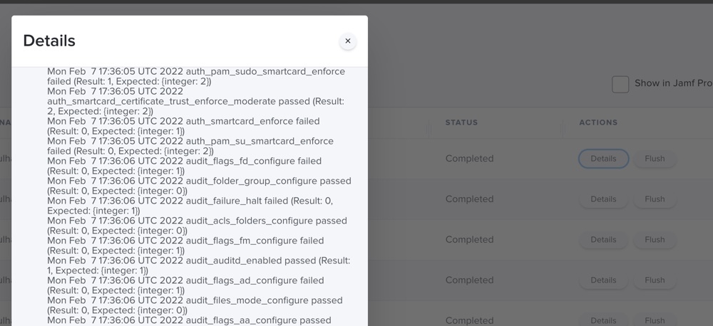

Does anyone know how to create an inventory report from a script policy?
I created a baseline script policy to get the logs/reports and generate them all in place. Instead of going through per device to check the logs.
Attached is the screenshot for further clarification.

As mentioned on the MacAdmin slack. You need to create an extension attribute. This looks like the script from the macOS security compliance project. As mentioned on the project, it creates a plist and a log file. You have to create an extension attribute in order to have a "report".
