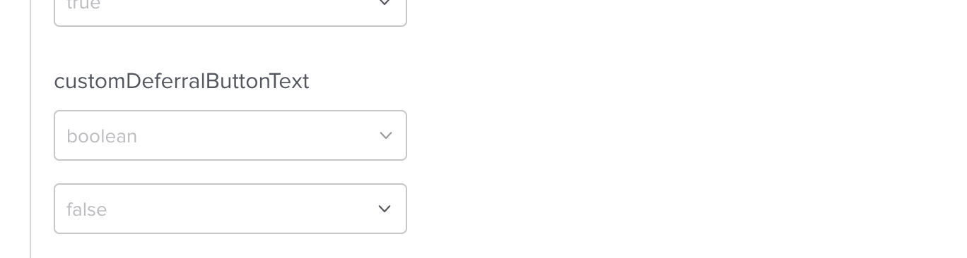

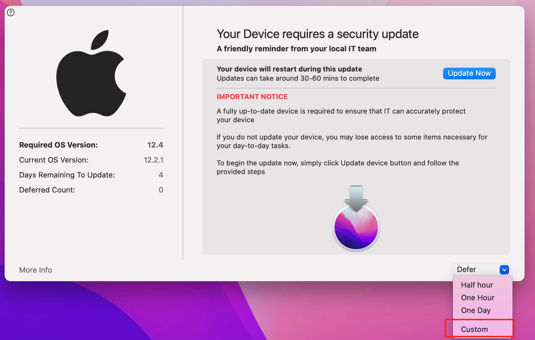

Hi there ,
I am trying disable Custom deferral text button to disappear or not exist on Nudge.
In the user interface option i have created this parameter ( screenshot below) , â€ƒbut doesn't seem to affect nudge when it loads ( attaching the screenshot) . Any advices on how to remove custom deferral text button from nudge?

Just double checking when you modified it did you send it back out to all devices or only newly assigned devices? I don't think it will update the profile if it's just newly assigned devices. Check the profile that's installed and just double-check you see the right key preference there. With Nudge, I usually remove the profile and reapply it. I just tested it out, pushed the profile, and now all I get is this.
Nudge is finicky, I like it but sometimes it just doesn't work as you expect it to.
