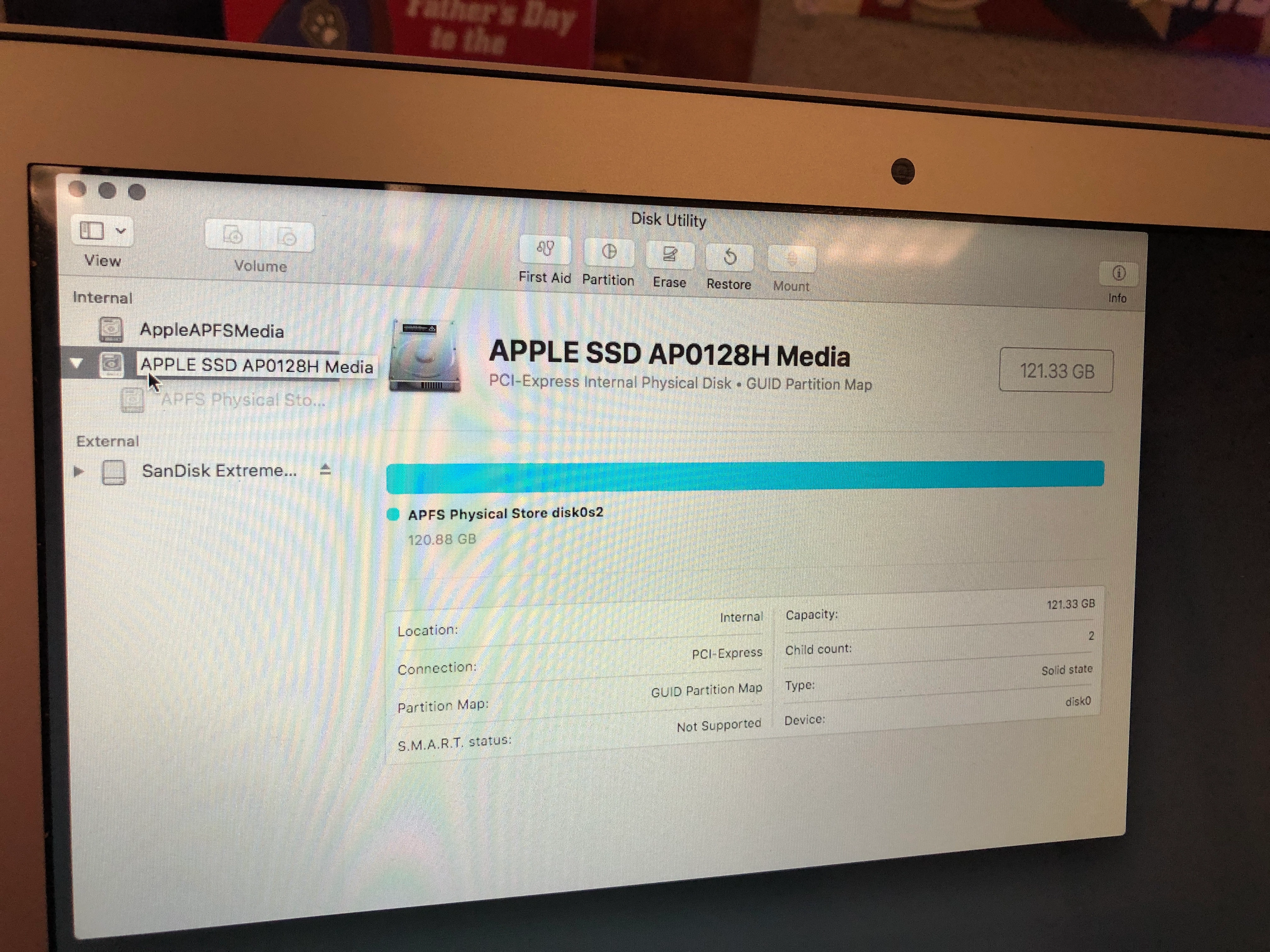

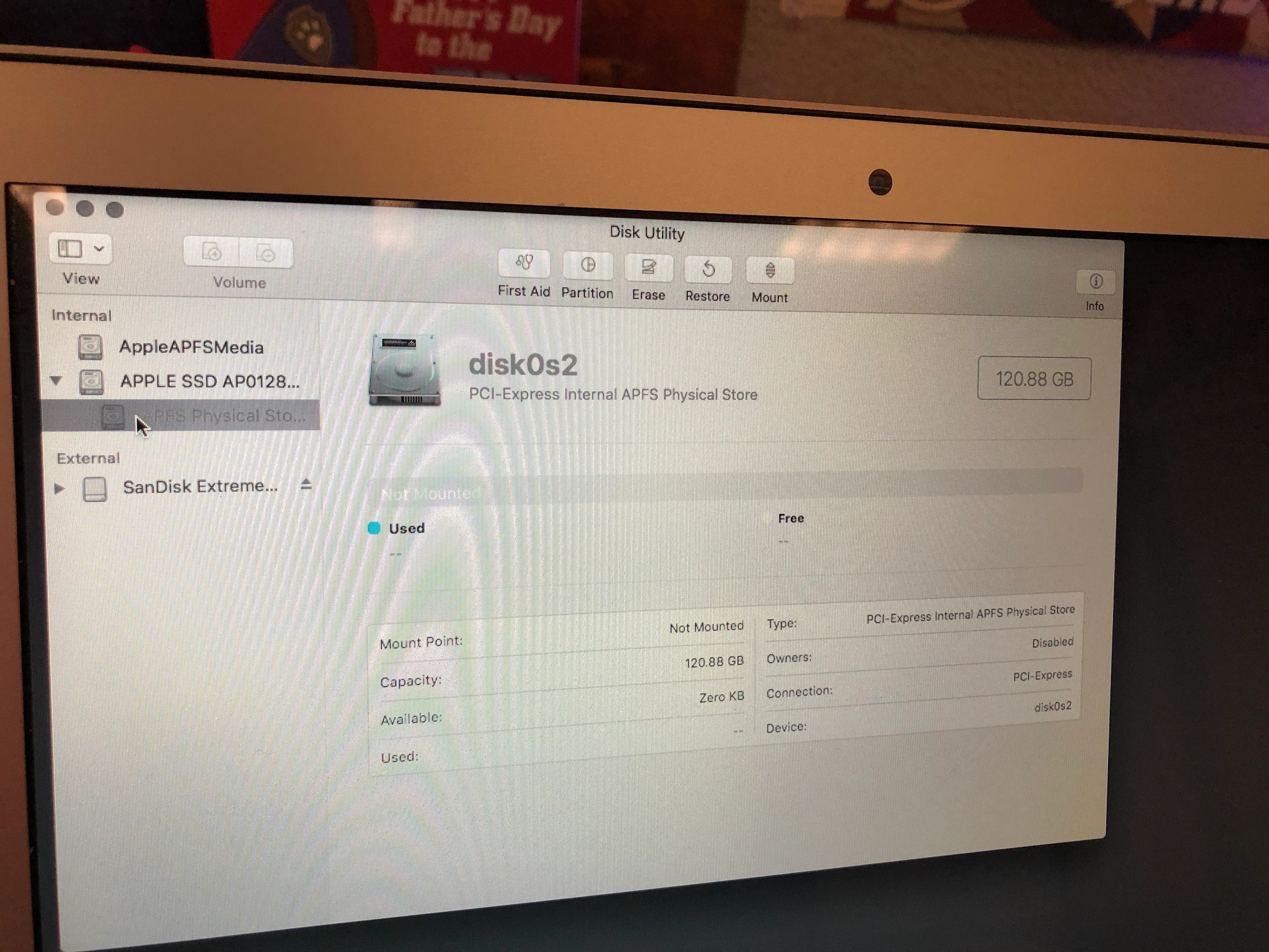

  • June 25, 2019
Unfortunately getting the same response. The firmware install shows as successful. Killed the process after it failed and opened disk utility and here is the state of the internal SSD. Prior to this it was MacOS Extended Journaled running 10.12.6.

@jredge Think I may have just run into the same problem you are having.
The problem is when the image is made on a larger byte drive. IE: All my macbook air 11" are 128gb, however some are JUST a hair lower in total bytes and so the image will not "expand". What I found I had to do was use Carbon Copy Cloner to image one of the smaller drives from the "large" image, then take a NEW image using Disk Utility of the "smaller" drive and use that as my master instead.
