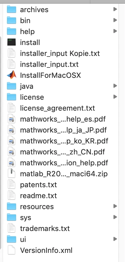

Thank you for your Answer. But I don't unsterstand the step 9 - 10. In Step 8 I edit the installer_input.txt:
destinationFolder=/Applications
fileInstallationKey=1234-1234-1234-1234-1234
agreeToLicense=yes
licensePath=./license/license.dat
I create a Folder in /Downloads/Matlab/license and copy my license.dat file in the folder.
That is what I do, can you explain the step 9 and 10. On the attachment, you can see my Folder Matlab in Downloads.

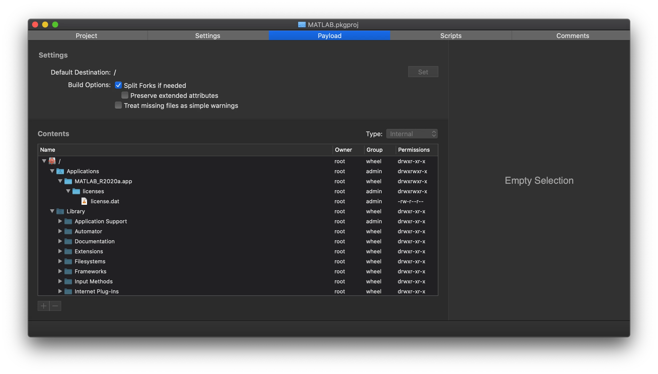

I use the Packages app to repackage the Matlab software. If you use something else your workflow will be a little different, but the end result should be the same. I can give more detail about how I do it in Packages though if that helps. The main thing is to put the license file in the right file path and to place those downloaded files somewhere on the Mac and then trigger the install from that directory. I use Packages to do this because it creates a temporary directory for those files and I don't have to worry about it.
More details about doing this in Packages,

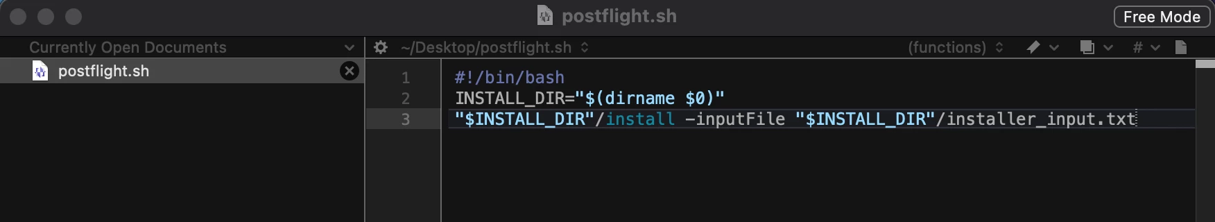

In the Payload tab of Packages, I add the folders where the app will be installed. The license.dat file needs to be in /Applications/MATLAB_R2020.app/licenses/, so I create that location and place the file there. Then, I put all those files that were downloaded (that are currently in the downloads folder) and drag them into the Additional Resources section of the Scripts tab in the Packages. Then I use a postflight script to set the directory and install matlab using those files (those commands are below, I can't share the whole script because of other customizations we do).
INSTALL_DIR="$(dirname $0)"
"$INSTALL_DIR"/install -inputFile "$INSTALL_DIR"/installer_input.txt
