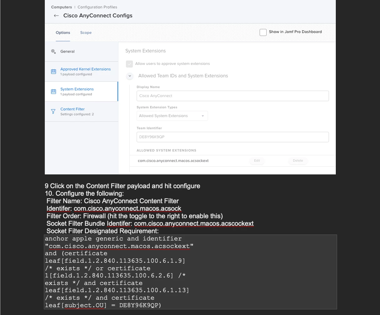

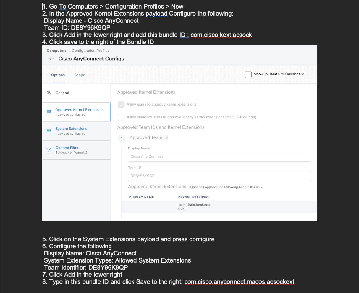

Bah, AnyConnect. AnyConnect is a nightmare and JAMF still does not fully support network extensions which AnyConnect needs. Also, if a Network Extension installs BEFORE the configuration profile that Manages the Network Extension there is no way to approve it with MDM, they user must click the buttons which is the reboot stuff you are seeing. This is basically working as intended… Thank you, Apple...
I would say try to try to flip devices from KEXTs to SEXTs (SystemEXTensions you can never unsee it now) a few days before trying to upgrade. Even if you let the KEXT and SEXT run side by side. Let the device marinate a bit. I think doing this KEXT to SEXT change and the OS upgrade at the same time may be compounding problems. Cisco's Network extensions were a nightmare for us and still are not perfect.
What version of AnyConnect are you using? JAMF gave us this guide back in Jan or so, this is when I learned if the Network Extension is installed 1st it must be manually approved.
Google will likely be a problem until you can move over to System Extensions. Big Sur still supports KEXTs but its more of a legacy thing and they dont work very well. I'm glad the rebooting it working. It also just clicked that was a screenshot of Mojave, we upgraded from Catalina to Big Sur I try to avoid skipping OS versions for many reason.
Apparently JAMF does not like attachments, so here are screenshots lol.
