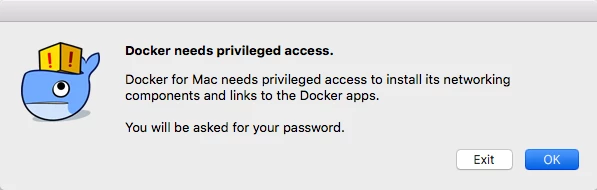

  11. Docker will ask for privileged access, click OK
  12. Enter your Admin credentials and click okay

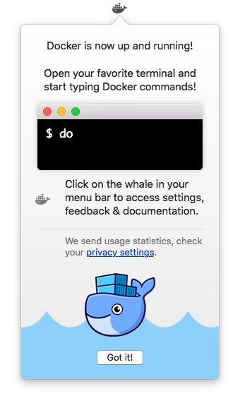

  13. Docker will run its final installation steps
  14. Click Got It after Docker has finished running its post-installation

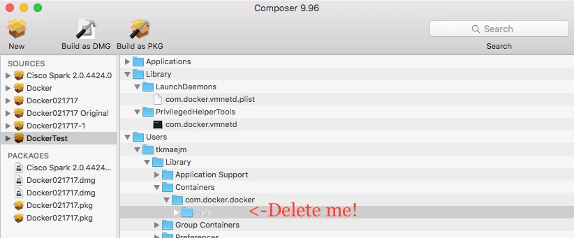

  15. In Composer, click Create Package Source
  16. Drill down Library>LaunchDaemons
  17. Select the com.docker.vmnetd.plist file

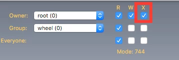

  18. Ensure that the file's owner is root, and group is wheel.
  19. Check the box for X (execute) on the Owner row. Verify that it states Mode: 744 (not 644)
  20. Drill down Users>{username}>Library>Containers>com.docker.docker
  21. Delete the Data folder within the com.docker.docker folder
  22. Ensure there are no additional folders unrelated to the Docker installation in the package source. In my case I removed the Saved Application State folder.
  23. Once you've done this, click on Build as DMG and save to your package build location

Change /Library/LaunchDaemon/com.docker.vmnetd.plist to 744 and root:wheel
Delete the Data folder found in Users/{username}/Library/Containers/com.docker.docker
Save as DMG, place on Casper Admin with FEU enabled
In Policy: Ensure that the computer restarts after install. Add the following one liner in Execute Command:
/bin/launchctl load -Fw /Library/LaunchDaemons/com.docker.vmnetd.plist

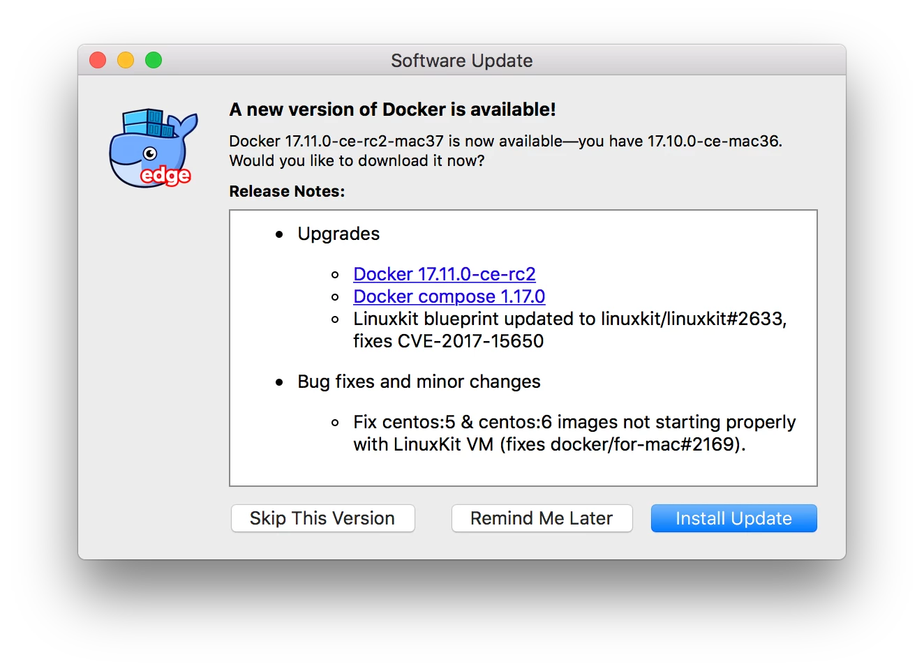

Hey @Jacher - have you had a chance to package / distribute an update? As a test I've successfully packaged Docker Edge and now just packaging the update in preparation to test the distribution of this.
I'd be interested to see if you have investigated how to suppress any update notifications. I've already had a support ticket raised about not being able to install the update without elevated rights.
Thanks!

defaults write /Users/$username/Library/Preferences/com.docker.docker.plist SUEnableAutomaticChecks 0
But it will just uncheck the checkbox, user can change it if he wants to.

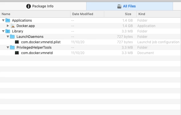

These post-install commands seem to be working for me:
cp /Applications/Docker.app/Contents/Library/LaunchServices/com.docker.vmnetd /Library/PrivilegedHelperTools
cp /Applications/Docker.app/Contents/Resources/com.docker.vmnetd.plist /Library/LaunchDaemons
chown root:wheel /Library/LaunchDaemons/com.docker.vmnetd.plist /Library/PrivilegedHelperTools/com.docker.vmnetd
chmod 744 /Library/LaunchDaemons/com.docker.vmnetd.plist

@tonybilzi I confirmed these commands work on version 2.3.0.4. Thank you for posting these as it saved me time trying to figure it out.

If anyone here uses AutoPkg(r), chilcote's Docker recipe adds the post install script to it automatically :)

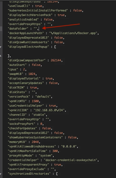

Greetings Nation,
I was given the task to find out why docker desktop was not working/admin prompt popping up. Our devices are 1 to 1, but I am sure something like Outset could work for shared devices. The version we are using is 2.4.0.0, and it is deployed via Self-Service. The following worked in our case. I am not sure if docker has posted an "official" method. I make no guarantees, and the usual rules apply test, test, test and use at your own risk.
I did not package it but will leave a suspicious package screenshot. The team had made the package with the user similar to the above process. Well, that was problem number one. That user was not on the production Macs, so soft linking did not work.
The next problem was that they did not have a post-install script. So I grabbed the settings.json file, made the below edit to "datafolder" to blank ( it will default to the current logged in user's home folder). I dropped it in /var/tmp and made a package.
Next, I used the following script, with help from all of you. So what this does is check for "/Users/currntloggedinuser/Library/Group Containers/group.com.docker" folder. If it is not present, it creates the folder then copies the settings.json file over to "/Users/currentloggedinuser/Library/Group Containers/group.com.docker". It installs the app Package, then runs the post-install. The last step was to create a PPPC file for the desktop folder, documents folder, and reminders(?) with PPPC Utility. I will tackle updates next.
currentUser=`stat -f "%Su" /dev/console`
/usr/bin/sudo -u $currentUser mkdir /Users/$currentUser/Library/Group Containers/group.com.docker
/usr/bin/sudo -u $currentUser cp /var/tmp/settings.json /Users/$currentUser/Library/Group Containers/group.com.docker/
sleep 5
/usr/bin/sudo defaults write /Users/$currentUser/Library/Preferences/com.docker.docker.plist SUEnableAutomaticChecks 0
/usr/bin/sudo cp /Applications/Docker.app/Contents/Library/LaunchServices/com.docker.vmnetd /Library/PrivilegedHelperTools
/usr/bin/sudo cp /Applications/Docker.app/Contents/Resources/com.docker.vmnetd.plist /Library/LaunchDaemons
/usr/bin/sudo chown root:wheel /Library/LaunchDaemons/com.docker.vmnetd.plist /Library/PrivilegedHelperTools/com.docker.vmnetd
/usr/bin/sudo chmod 744 /Library/LaunchDaemons/com.docker.vmnetd.plist
/usr/bin/sudo launchctl load -Fw /Library/LaunchDaemons/com.docker.vmnetd.plist
/usr/bin/sudo  rm -rf /var/tmp/settings.json
