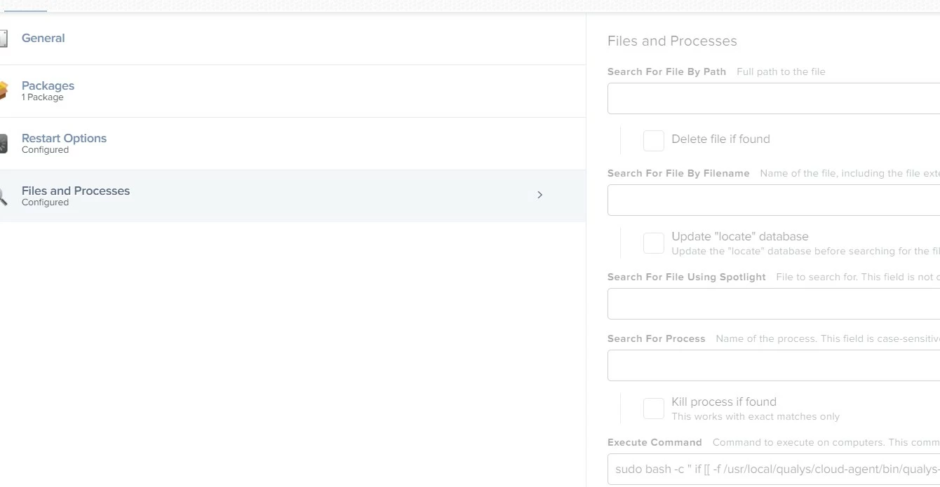

Is there a reason this can't be run under the pkg policy, on the Files and Processes configuration? The Packages installs the Qualys pkg on the distribution point, then Files and Processes runs the bash -c. (I've already taken sudo out, the screenshot reminded me it was there). That's how I have it set up and it according to our Qualys admins the Macs are reporting in and all looks good.
