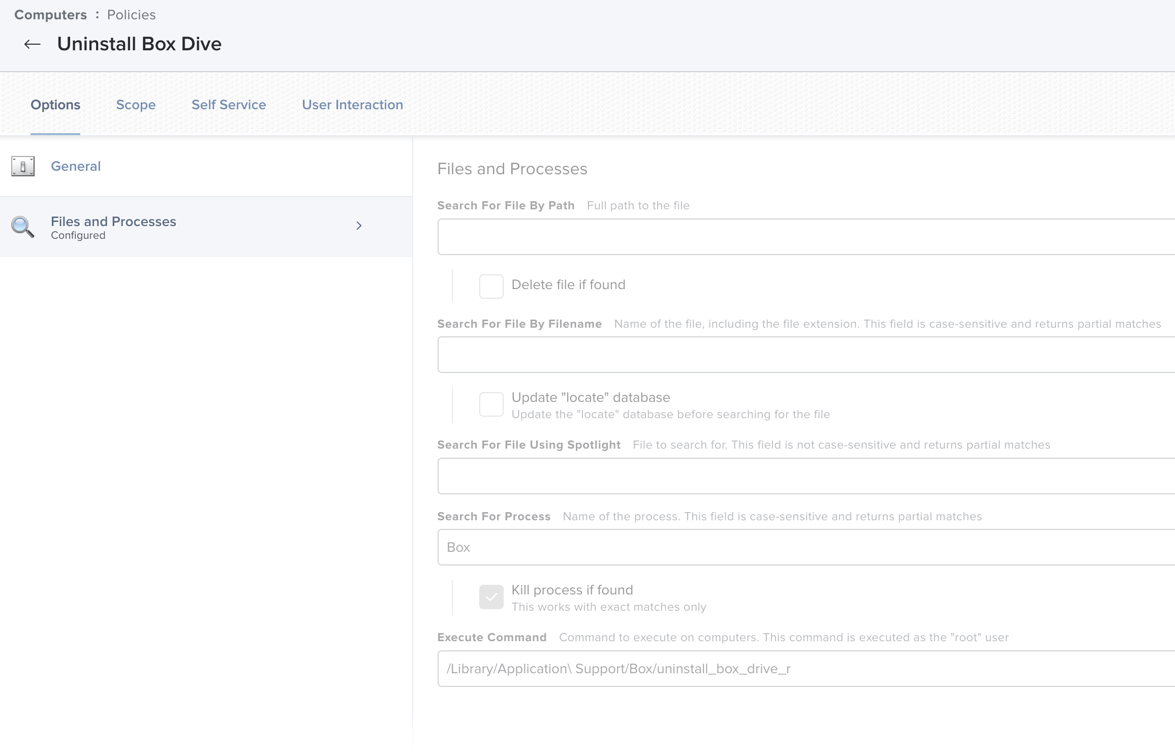

Here is my working policy
Thanks @geoff_widdowson! In my initial testing I didn't include the kill process for Box. But not only that, I was running
/Library/Application\\ Support/Box/uninstall_box_drive (without the _r) (just as the Box article states) as a policy command, and it kept erroring out mentioning not to use Sudo. I wasn't entering sudo in the command at all. Anyways, your process seemed to have uninstalled Box, and so thanks for your help.
Your policy didn't work for me (as of version 2.26.330). It still kept saying not to run it with sudo. I ended up removing the "Search for Process" entry and the "kill process if found". I used this in the Command box:
killall Box ; /Library/Application\\ Support/Box/uninstall_box_drive_r
and that worked.
