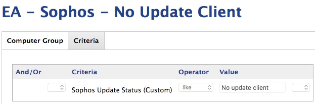

- If Sophos is not installed, the EA will be set to "No update client"

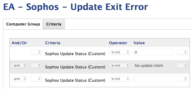

- If Sophos is installed and fails to update properly, which typically indicates that there is a registration issue or other failure, the exit code will be non-zero

Two smart groups are defined by the results of this EA. One monitors whether the Sophos update binary exists, and the other monitors whether the Sophos update binary exited with an error.
And we tie those into some other policies that automatically install or uninstall-reinstall Sophos as necessary and that file helpdesk tickets for ongoing issues related to clients with Sophos cloud agent issues.
