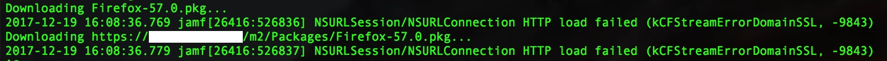

We have our JSS and our main DP on the same server. We are configuring downloads over HTTPS but have issues with getting it to work.
We can fetch packages just fine when opening a browser from a client and manually entering the URL for the packages on the server. When running jamf policy -verbose from a client we get the following error:
We are not using a self signed cert.

I'm almost certain you're seeing an SSL cert issue. Does the machine you're testing on have installed and trust the cert that's being used for SSL?
I tend to test with plain HTTP initially when I set up a HTTP/S DP and then add SSL into the mix once everything is working.

@stephanpeterson We solved it! It was a bit of misconfiguration from our part. Instead of the hostname to our DP we had put the IP address instead. Im not very well-versed into certificates but I guess it cannot validate with the just the IP address. Changing it to the hostname solved it!
