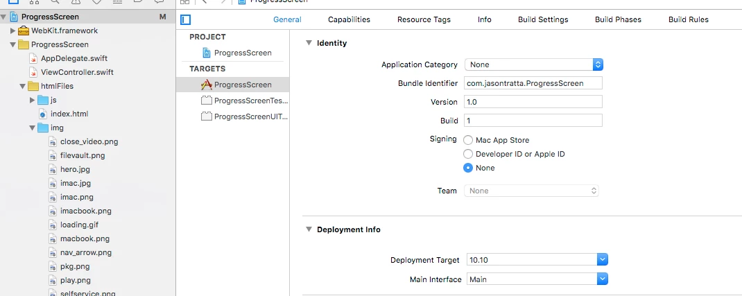

@jphillips You can change the deployment target in Xcode if you want to deploy to 10.10 as well. You can see in this image under Deployment info where you can set the Deployment Target.

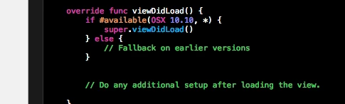

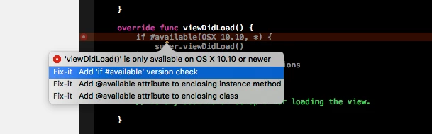

You can easily compile to at least 10.9. If you do so, Xcode will throw an error and suggest adding code to the viewDidLoad method. Click the red "!" and it will take you to the offending code seen in the images below. This should then work in 10.9. (*Disclaimer: I have not yet tested this on target machines)

@jtratta I had already changed the target deployment to 10,10, but the bar still didn't show for some reason. I have not tried taking it to 10.9, though.

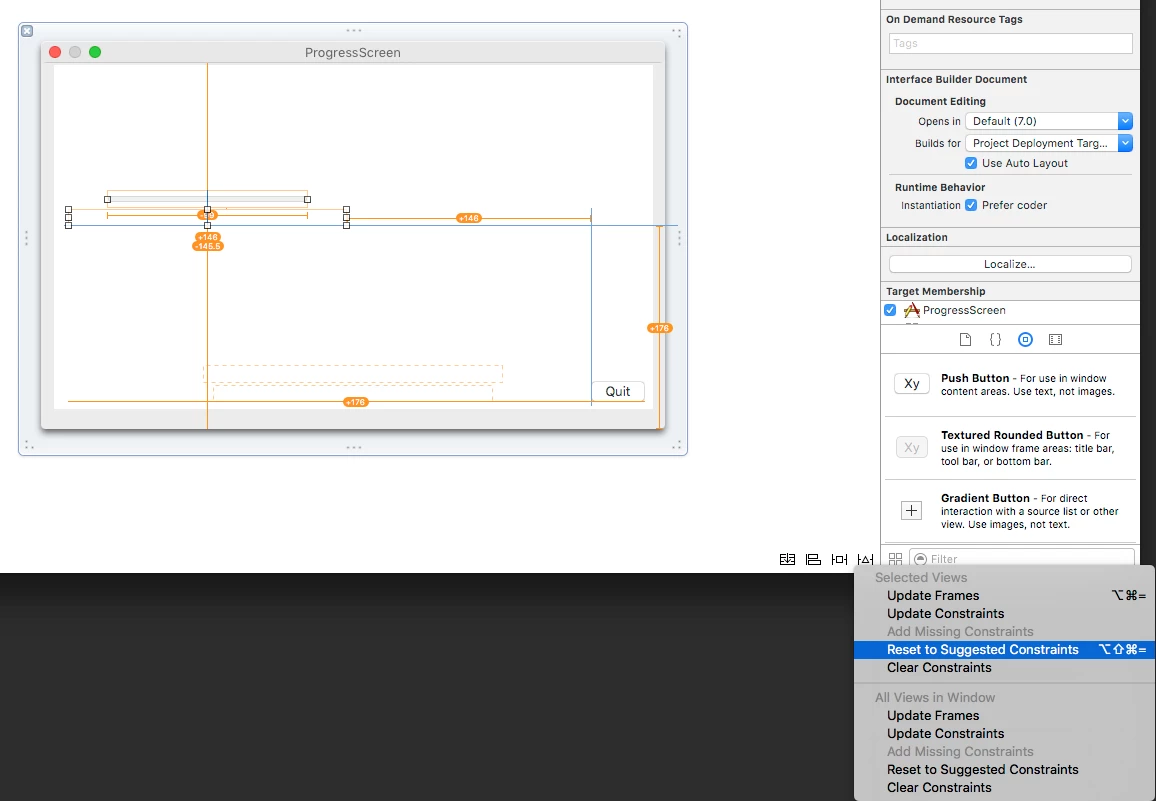

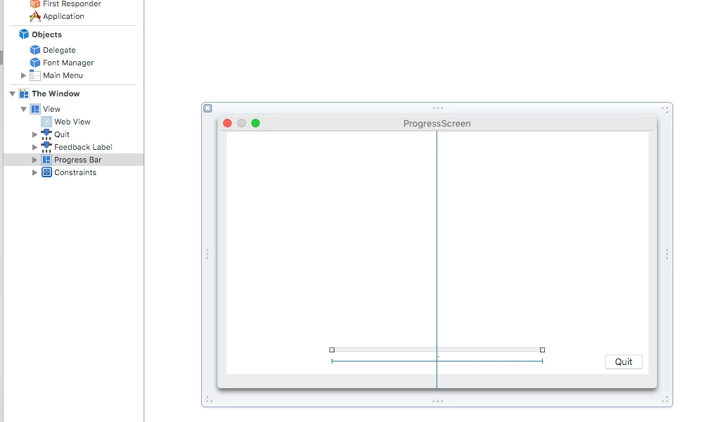

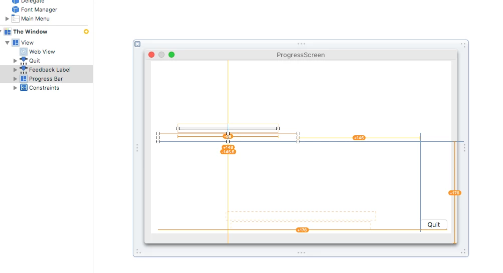

@mbezzo @hkabik I imagine you guys are probably running into problems with auto layout. If you select "MainMenu.xib" in Xcode you'll find a section called "The Window." The Window contains the web view (used to display your HTML), the progress bar, feedback text, and the quit button.
1) Click on the progress bar, it should highlight.
2) Move the bar to where ever you like. In this image I'm also moving the feed back text.
3) Now you need to set the constants for Auto Layout. One of the easiest ways is to select "Reset to Suggested Constraints" from the triangle-like menu at the bottom of the screen.
This isn't full proof. You might need to monkey around with the constraints to get exactly what you want. The other buttons at the bottom of the screen also deal with setting constraints. If you really want to dig into it...just Google Xcode Autolayout. I've also noticed an odd bug with the progress bar that if you make it too long, it vanishes when the app goes full screen.
  • Dec 4, 2015 3:15 PM UTC
Thank you! That's exactly what I was looking for and wow - being new to Xcode that just wasn't as obvious to me as I was thinking. :)
Thanks again!

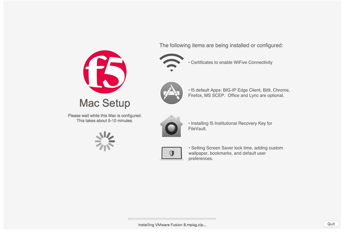

weird, I so posted a "thank you" reply last week, but it seems to have disappeared! So, thanks again @jtratta - that was great advice.
After playing around with it for a bit, I decided to just leave it at the bottom and centered. I borrowed heavily from IBM's app, and just put a GIF spinner in place. So I've got two versions of this now - one for our initial "machine level" settings, and then a second for when we customize the user profile. I'm pretty happy with it!
