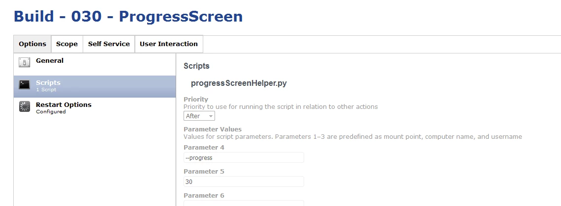

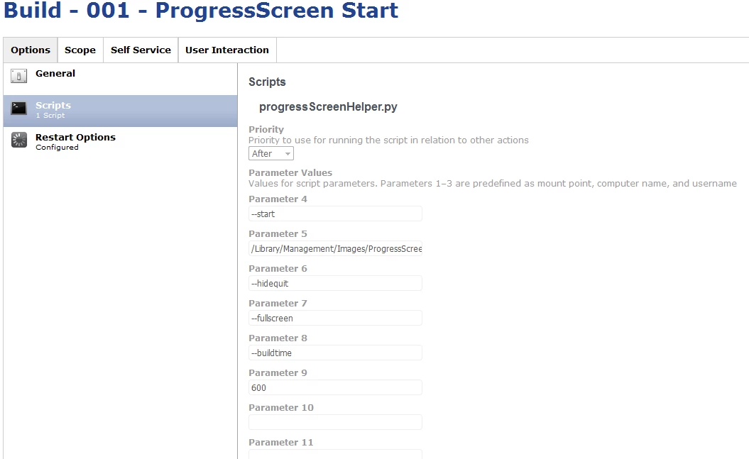

loceee
  • Dec 5, 2016 2:20 AM UTC
Finally getting to build out something with ProgressScreen (love it).. don't love the AppleScript interaction from a jam policy. This might some people out.
https://github.com/loceee/OSXCasperScripts/blob/master/progressScreenHelper.py
Lets you call and configure ProgressScreen easier from a JAMF policy. Set build time (persistent from across a session) so you can then set the progress as a percentage as you build policies run.
I don't love massive build scripts and would rather have policies doing the work with helpers scripts where needed. It's more visible and flexible that way.
Thanks again to @jtratta for a great tool!
optional arguments:
  -h, --help            show this help message and exit
  --start [[html_path]]
                        start ProgressScreen with [html_path]
  --fullscreen          set fullscreen mode
  --hidequit            hide the quit button
  --buildtime [build_time_secs]
                        set [build_time_secs] for progress bar
  --progress [progress_percentage]
                        set [progress_percentage] (based on build_time_sec)
                        for progress bar
  --waypoints [app.pkg] [app.pkg] [app.pkg] [app.pkg]
                        set waypoints to [app1.pkg] [app2.pkg] [app3.pkg]
                        [app4.pkg]
  --end                 quit the app and remove temp file

loceee
  • Feb 22, 2017 11:18 PM UTC
What @loceee said back here
It might look a little summink like this...
