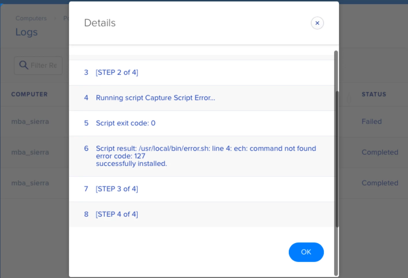

@seann is correct, the error from the called script still causes the policy to show failed. If I redirect the output to a file though things look to work. Agree with @mm2270 in that it'd be nice to just resolve the install error. However, if you're interested this worked for me.
install_result=$(/path/to/SPSS_installer_script;echo $? &> /tmp/error)
error_code=$(cat /tmp/error)
echo "error code: $error_code"
case $error_code in
    0|127|208)
        echo "successfully installed."
        echo "failed to install.  result: $error_code"
        exit "$error_code"
esac
I added 127 as an acceptable error code as that's what my test script generated. You'll notice in the policy log it captured the 127 error but shows a successful install (line 6).
