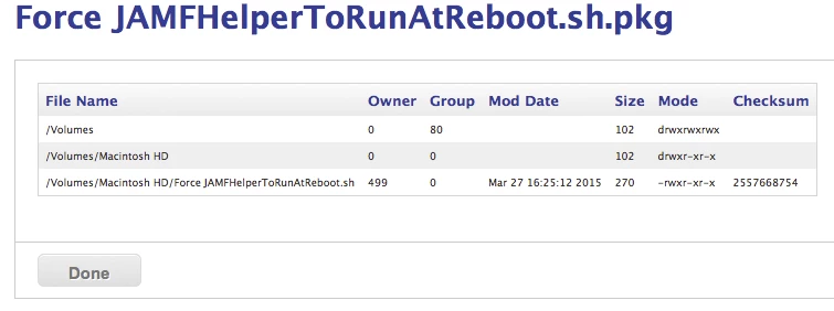

msample
  • March 27, 2015
This worked out to be a super solution for me also. This is what the script looks like when packaged and placed at the root. This was applied to OS 10.10.2.
