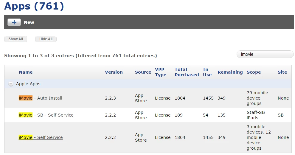

We also have this issue with imovie. it seems the only thing that has worked is complete removal and reinstall. Verified issue exists with ios 10.2 and 10.2.1, imovie version installed is 2.2.3 on the ipad and in jss for the deployment that it is in, however I have two other apps in my app catalog that are on a previous version. jss version was updated yesterday v9.97.1488392992 for this bug fix:
[PI-002627] Fixed an issue that caused mobile device apps to reinstall if there are duplicate app entries in the App Catalog and one entry is an older version, regardless of scope.
I will update the other two deployments and report back.

Updating the other two app catalog applications produced no change. We currently have a case open with jamf support engineers.
