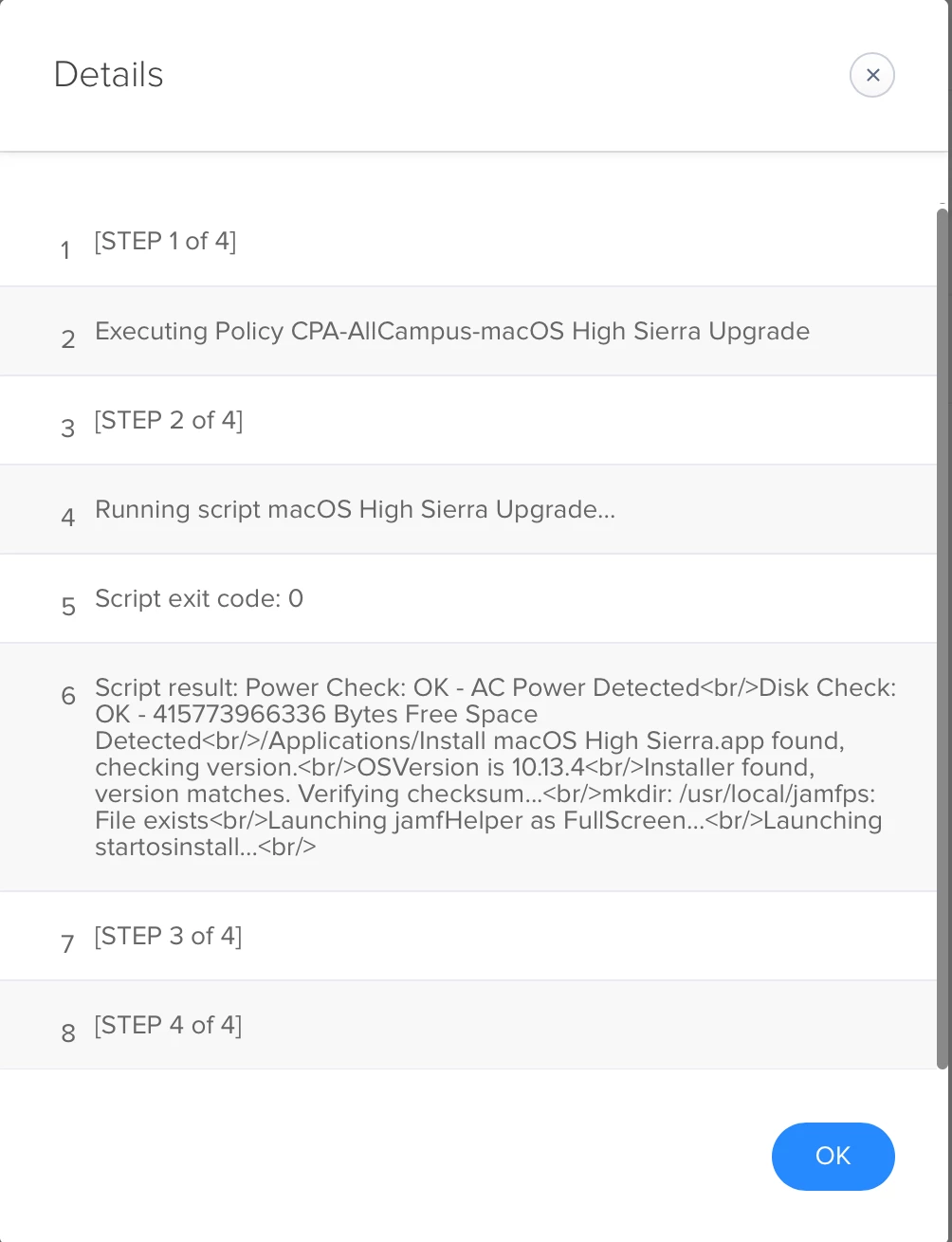

  • May 4, 2018
@Rosko
All Thank you all for you hard work on this. I seem to be struggling and being a newbie I am at a loss.
I have performed the following:
- Created two policies:
-- 1.) One to cache the Install macOS High Sierra.app in the /Applications folder - works successfully
-- 2.) The current self-service policy to install the OS using the script provided by Rosko from GitHub https://github.com/kc9wwh/macOSUpgrade
Issue: the Splash screen appears "Please wait as we prepare your computer for the macOS High Sierra..... This splash screen sat here overnight.
Troubleshooting:
- Looking through the install.log from /var/log/install.log I do not see any errors or the startosinstall
- Looking through the JAMF.log it says "Executing Policy CPA-AllCampus-macOS High Sierra Upgrade
- In JAMF I receive the following:
What am I missing?
Thank you in advance!

  • June 5, 2018
@Rosko
Thank you for getting back with me. I apologize for not getting back with you sooner.
I found the issue.
There was something wrong with the install macOS High Sierra.app. I could not even launch it manually. I created it on a VM using Extended Journal. So, this might had something to do with it. I grabbed another physical computer and built it from there. Seems to be working now.
I also had to hard code the User Variables in the script. As they were not working when inputting them into JAMF.
But hey, it is working now. Woo Hoo!

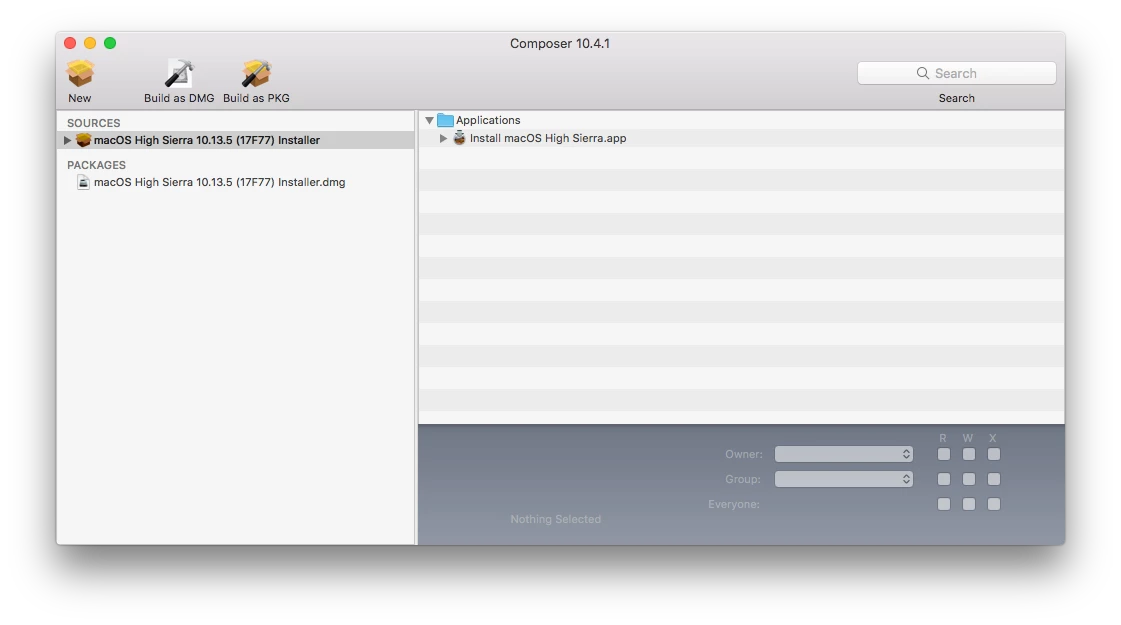

dan-snelson
Forum|alt.badge.img+30
  • June 12, 2018
@rkovelman Searching for The button section in the following may help: Reinstall a clean macOS with one button.
stevewood
Forum|alt.badge.img+38
  • June 12, 2018
@rkovelman you do not "cache" the installer in the traditional Jamf sense. Meaning, in the policy to cache the installer you do not choose "Cache" on the package. If you follow the instructions on the GitHub page, you use Composer to package up the installer, whether as a DMG or a PKG. If you install that PKG/DMG it does not run the OS installer, it simply places it where you want it.
So if you want the installer in /Applications, just install your DMG file. It will copy the OS installer into the folder and it will be there for the script to run against.
Make sense?
  • June 12, 2018
@stevewood i get what you're saying but I don't at the same time. As of right now the machines that need the upgrade have the 5GB installer in that hidden JAMF folder. Could I execute a script to open the DMG, and copy the contents of that into the Applications folder? Once that is done I can then have it delete the DMG file? I would think the whole point is to cache the file to the machine 1st, and then unpackage it. I dont see a way with the composer to have it install the file in the Applications folder.
mm2270
  • June 12, 2018
@rkovelman First make sure the OS installer is in the main Applications folder where you want it to go, then in Composer, drag the installer into the sidebar (Sources) list. It will copy the installer in and create a new source, that you will likely want to rename, then build the package as a pkg or dmg file.
When the package gets deployed it will 'install' the installer into that location, but not run it. That's what the script is for.
Incidentally, you could install the installer in any location you want to, but would need to slightly modify the script to point to the correct location as well as using a different sed command to get the installer name. I'm doing that in my version of the script for this process. The main Applications folder is not a hard fast rule, just a suggestion and the script has some hardcoded stuff in it that expects it to be there. But it can be changed if you prefer.
dan-snelson
  • June 12, 2018
@rkovelman Here's a screenshot of @mm2270's suggestion. (I prefer to build as a DMG.)
  • June 12, 2018
@dan.snelson I did that and clicked DMG. From a cache perspective, it still places it in the hidden folder. My guess is to run the cached policy and it will throw it in the Applications folder? From there it should work as normal, no? I think that is the missing step most fumble on?
mm2270
  • June 12, 2018
@rkovelman the problem is you need to use "install" in the policy as the action for the package, not "cache". If you use cache then yes the package will just sit in that folder until something acts on it. Change it to install and when it runs it will place it in the Applications folder.
Edit: I think to add, where you're getting tripped up is that this isn't a real "cache" as in a Jamf caching process. Think of it like installing an app like Firefox or Google Chrome. You wouldn't (normally) set up a policy to cache that, then install it later, unless there was a specific reason for that. Usually you just tell the policy to install FF or Chrome and it lands in the Applications folder. This is the same thing, just that it's installing the Install macOS High Sierra.app. Folks here use the term 'cache' because it needs to be differentiated between running the actual app and "installing" High Sierra on the Mac. Make sense?
dan-snelson
  • June 12, 2018
@rkovelman When you drag "Install macOS High Sierra.app" to Composer, is it located in the Applications folder or your hidden folder? (Please see mm2270's instructions above.)
  • June 12, 2018
@mm2270 thanks, setting up a test machine and will do that!
  • June 12, 2018
@dan.snelson its in the applications folder. By default when you cache a policy it goes to a hidden or locked JAMF folder. As mentioned above it sits there waiting to be executed on.
dan-snelson
  • June 12, 2018
@rkovelman Thanks for clarifying. As mm2270 mentioned, your policy should install the DMG, not cache it.
